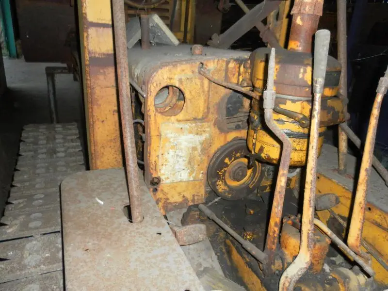

one more question I have a Trackson T2 loader serial no. 5U365 that has been fitted with electric start on the starting engine, the dash panel
has a hole cut in the left hand top corner about 4 inches in diameter this looks like a factory job as it is very neat and has a very smooth edge,
my question is as this tractor has an early serial no. is it correct or should the dash panel have a bulge like the later machines to accomodate the electric starter?

Here is the photo[attachment=15939]T2 & 212 007.jpg[/attachment]
Iv' finally ******* done it !

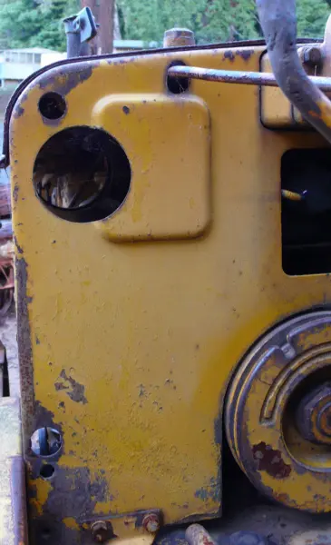

The Dash cutout is correct for an early U model with pony electric.

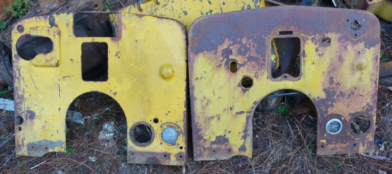

Over the years that the D2 was produced, there were a bunch of different dashboard types, and the parts book did a poor job of showing the different cutouts and bumps, here are pics of some of them.
