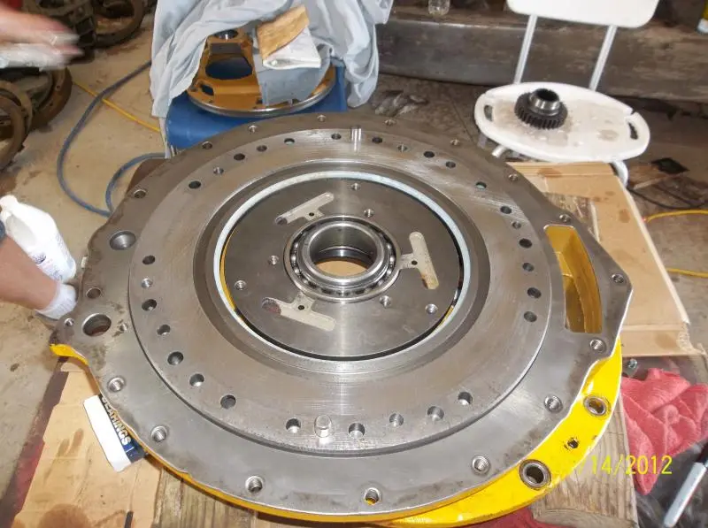

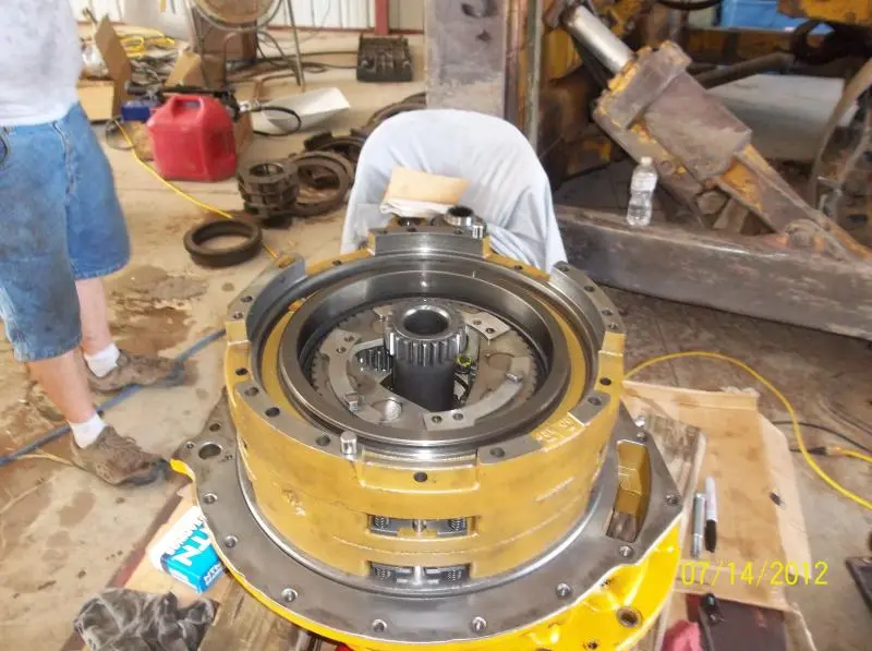

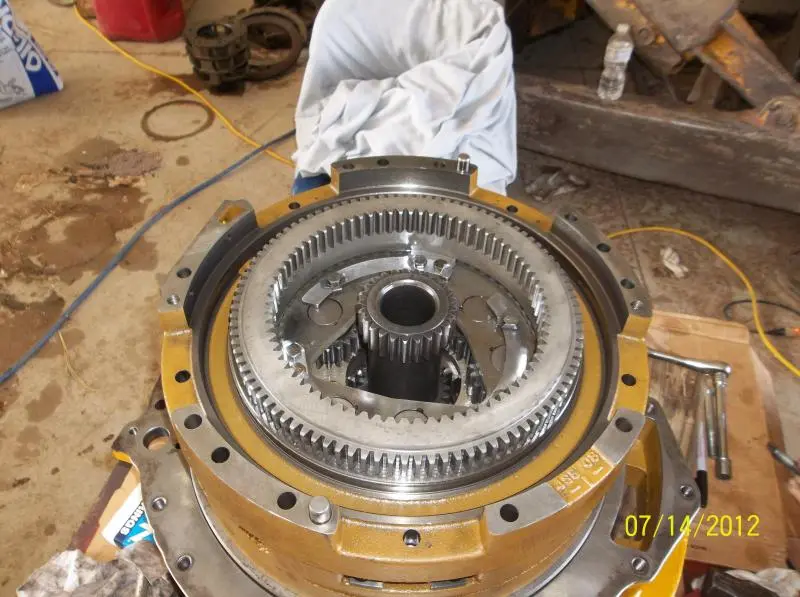

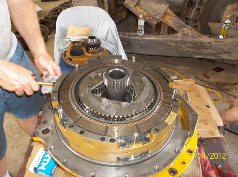

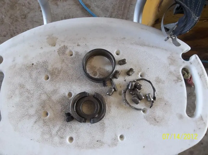

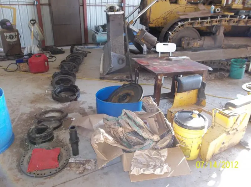

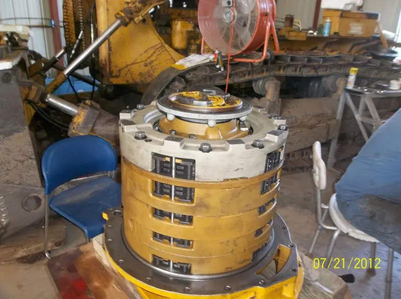

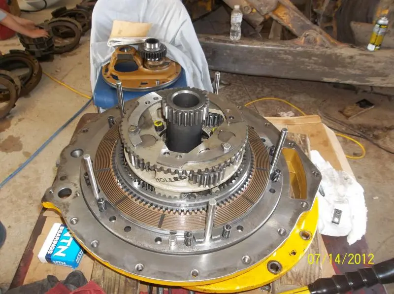

Helped a guy replace pinion shaft bearings. Then took trans apart to clean and make sure any pieces didn't get in. As my friend says: It's just nuts and bolts. Just make sure to keep track of location and position of pieces as you remove and replace.
