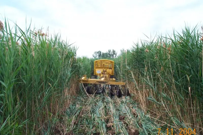

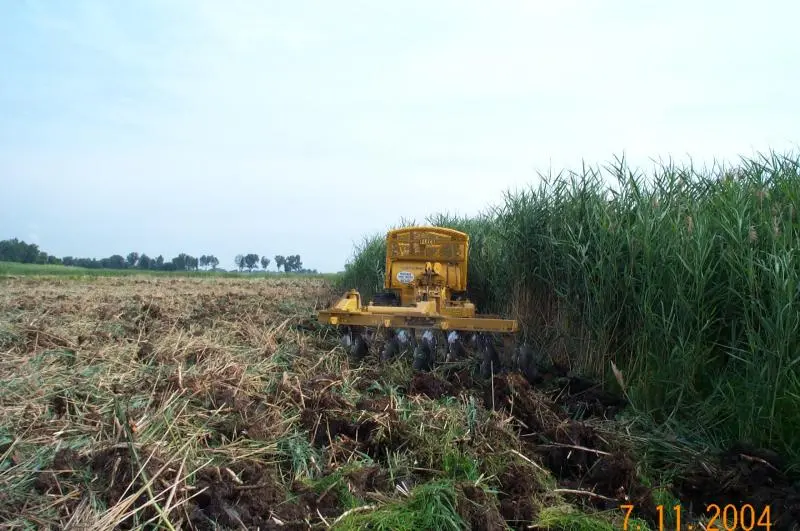

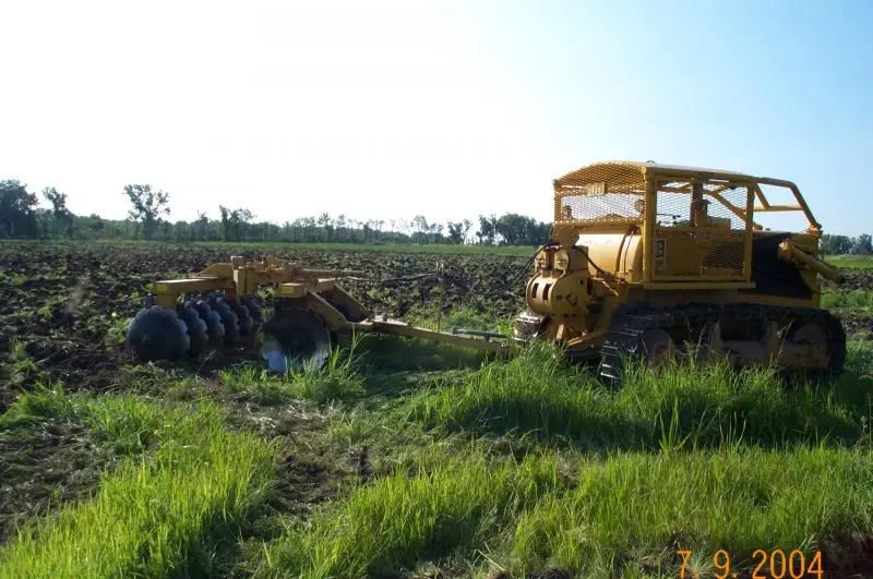

You need to have the blade scrapers or like mentioned chain but chain may wear the disk spacers. Pic is my TRCH 12-36 disk.
Wed, Nov 19, 2014 8:57 PM
Some more pics disking marsh ground.
Wed, Nov 19, 2014 9:07 PM
Posts: 2,017
Thank you received: 37

Wow that is a nice looking disk Rome! Mine is a TRH16-32" blades. 14" spacing. It has new front blades and older rears. Got the scrapers in and they are a heavy bit of steel. About 35# apiece.
