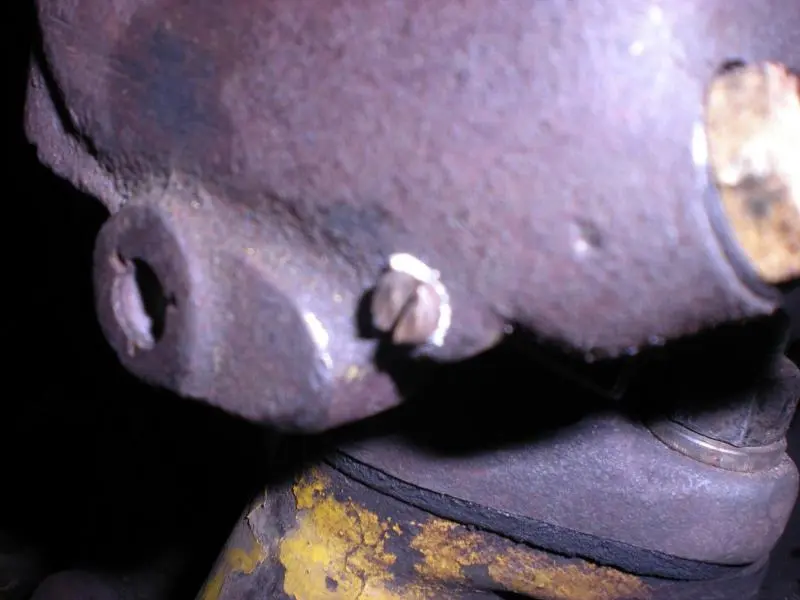

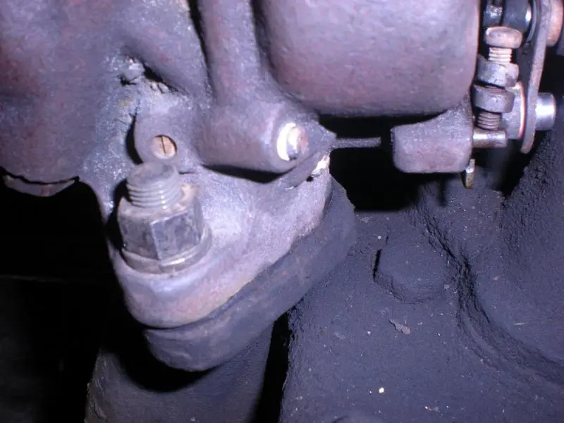

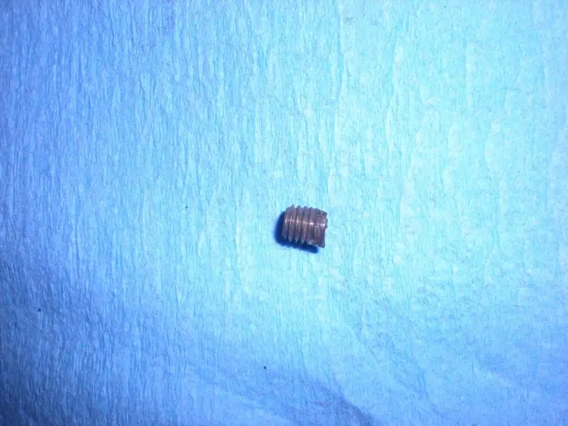

Here's some photos. The plugs I used are ones that go into various two cylinder john deere carbs (A, G, ect) the thread is 10-32 I think. The holes are already the right size you just have to tap them. At least that's how mine was.
After I went through all this mine still wouldn't idle without some choke. This drove me nuts. Finally I looked real close at the idle ports ( the ones in the brass plug) there is a large port and a small port. The large port needs to be BELOW the throttle plate. Mine was upside down, once it was in the right way, presto, good idle without choke.
[attachment=27196]DSCN4485.jpg[/attachment][attachment=27197]DSCN4482.jpg[/attachment][attachment=27198]DSCN4480.jpg[/attachment][attachment=27199]DSCN4484.jpg[/attachment]
I hope this is clear as mud.

check out this thread (Pony-rebuild-in-progress) If you do a search for it and look it over you will see how I drilled and re plugged all the passages. and took a bunch of photos to look at. It sounds like your not getting enough fuel I bet there is still some crud somewhere
