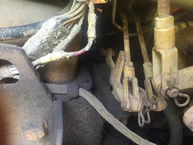

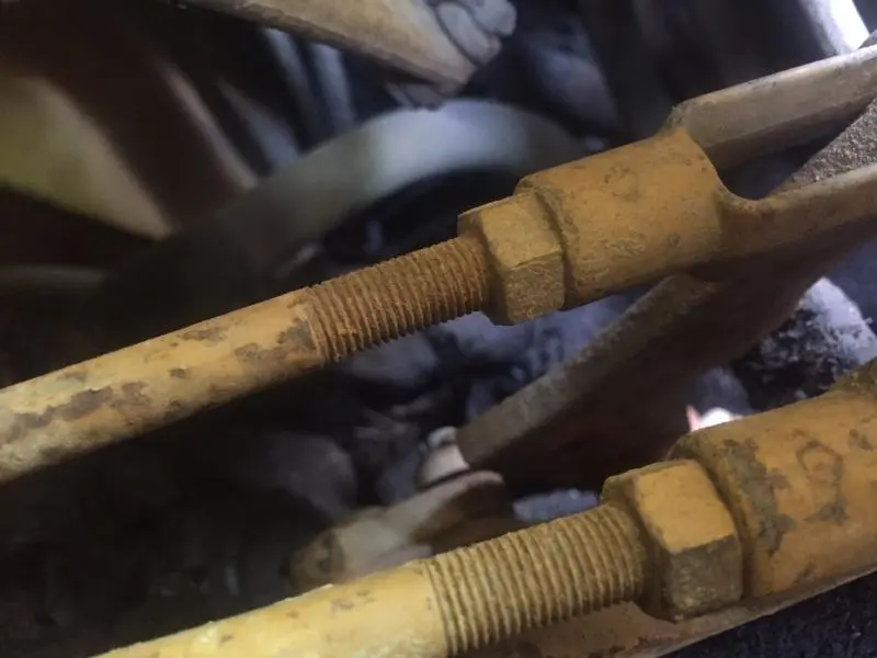

I checked the linkage. I noticed the left peddle pushes up on another lever behind it when you depress it. The right peddle is close to it but doesn't engage it. It looks like there may have been a bolt in it that fell out. [attachment=36430]IMG_5534.jpg[/attachment]
I've attached a picture of the linkage.
[attachment=36431]IMG_5533.jpg[/attachment]
Thank you again for your help.
