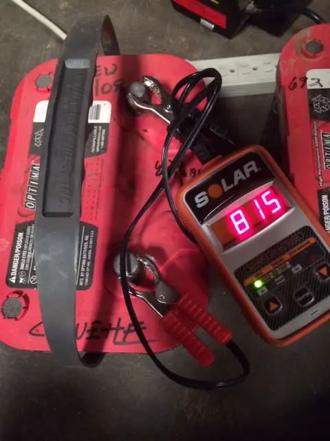

The new generation battery chargers and maintainers advertise that they can reverse the process of sulfacation. I took an 8 year old Optima Red Top that was starting to show signs of weakness. It originally came with advertised 800 CCA. Using a Clore Automotive BA7 Solar battery system tester, these batteries often show 850 CCA when new. This battery was down to 624 CCA and would drop to 12.2 volts in 24 hours after the equipment was run.
I hooked it up to the latest generation Clore Automotive charger for a two week time period. My charger looks just like the Clore unit so I think it was made by Clore but rebranded. After 2 weeks, I took it off the maintainer and let it sit a day. The BA7 tester, which checks the CCA by measuring the resistance, showed it now had 815 CCA and the voltage was 12.6. One week later it showed 790 CCA and 12.5 Volts. I have not put it back in service yet but it does look like it was improved. I am currently one week into another test on an identical Optima that was down to 470 CCA.

I called the tech department at Clore Automotive and asked about the ability of their charger to renew old batteries. The tech guy said that they will improve "lightly sulfacated batteries." My very limited test seems to back this up. The original battery described in the first post is still showing around 800 CCA. The second battery which started with 470 CCA out of the original 800 was not improved with a 2 week run on the charger. It is still close to the original 470.
I currently have the charger on a Blue Top Optima with an original CCA of 750. It is eleven years old and it now has around 100 CCA. I do not have much hope here but it is worth a try.
You cannot buy these chargers directly from Clore. They are the manufacturer and sell to retail outlets. They make several models and I think this line is called Pro Logic. Mine shows no Clore model number but I think it is a 2320. There are other maintainers making similar claims so check the descriptions and give it a try. They could be very effective if you start early in a battery's life.
