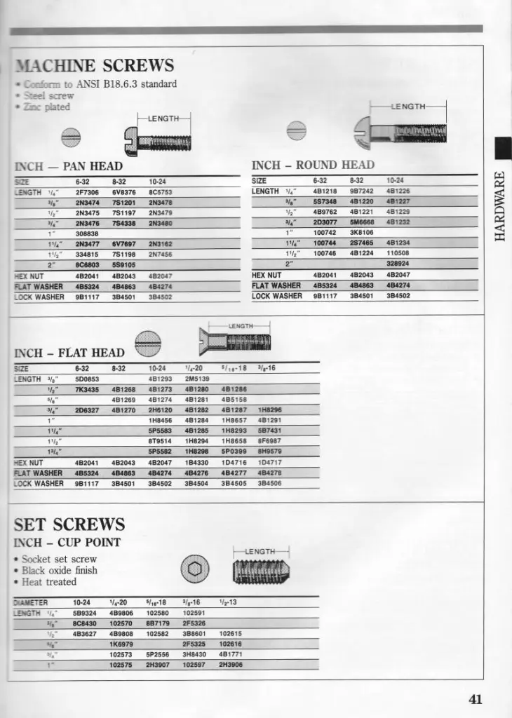

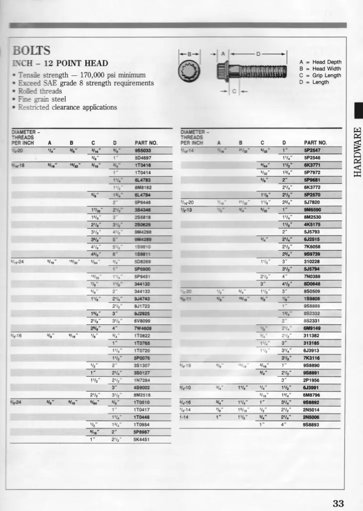

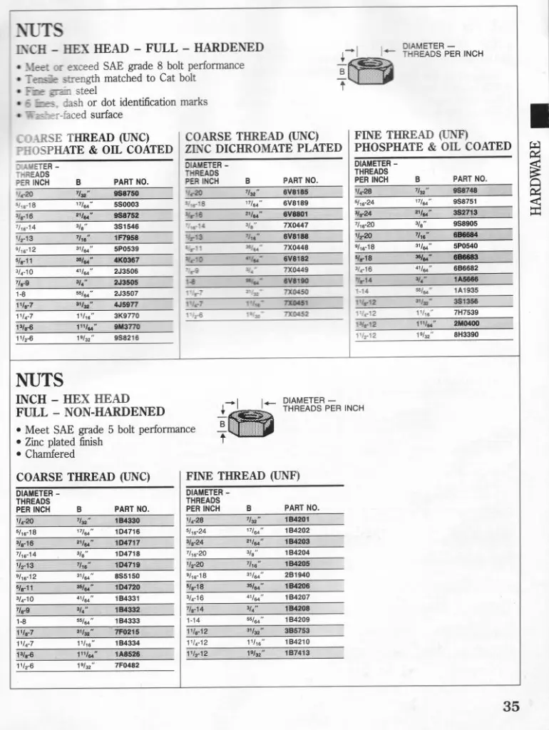

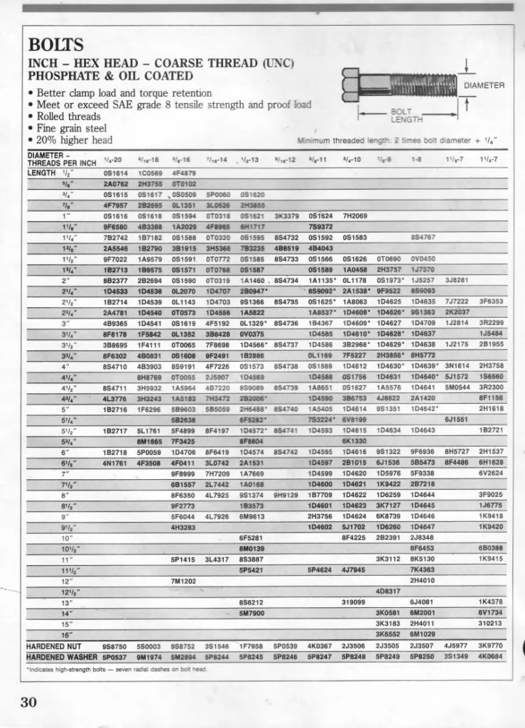

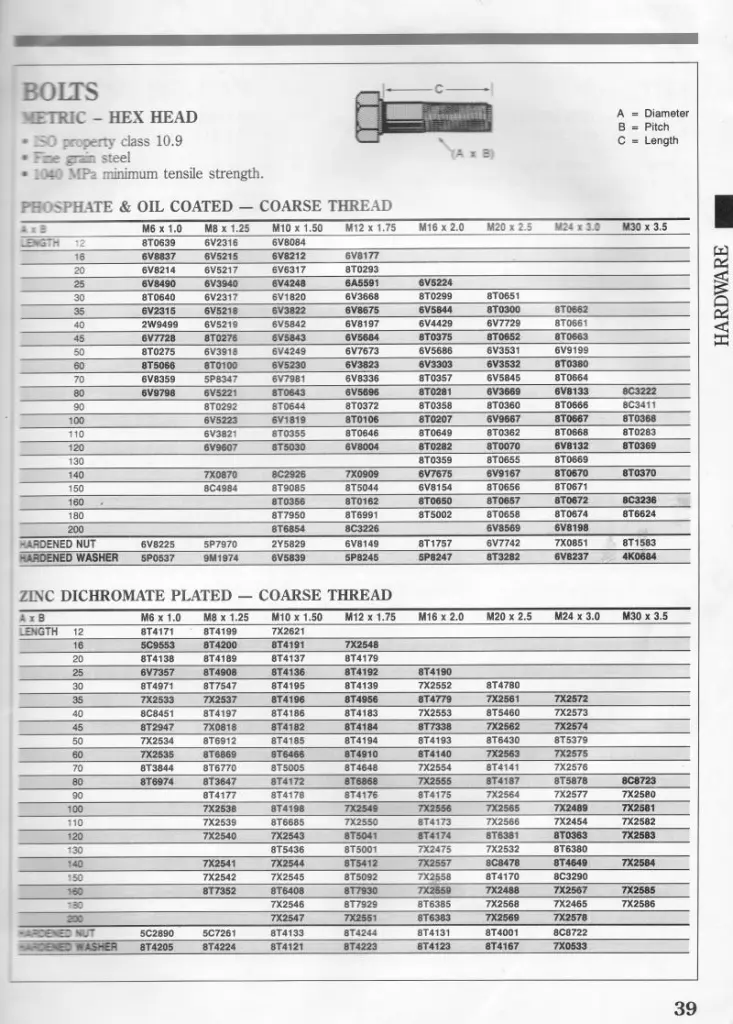

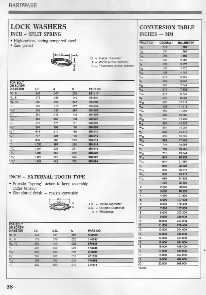

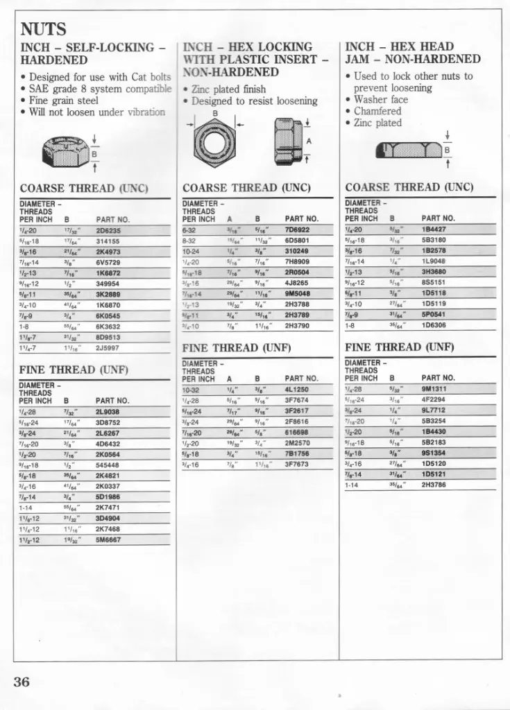

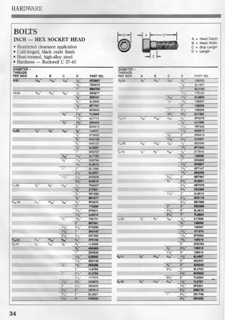

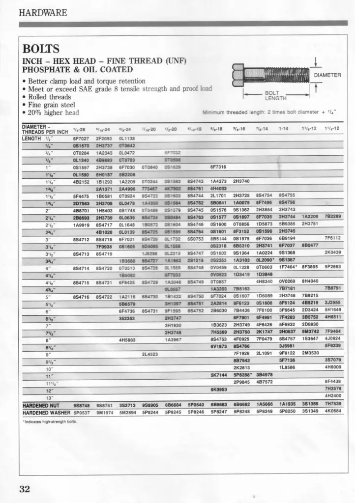

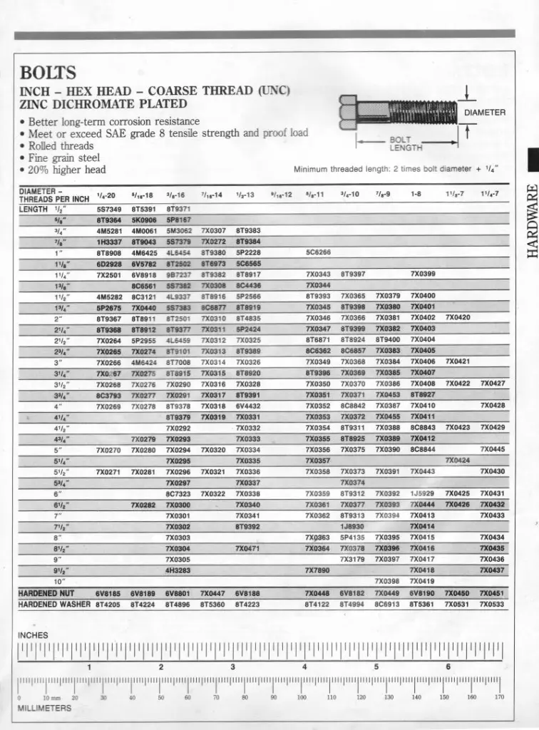

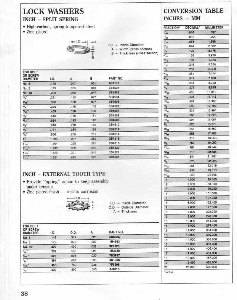

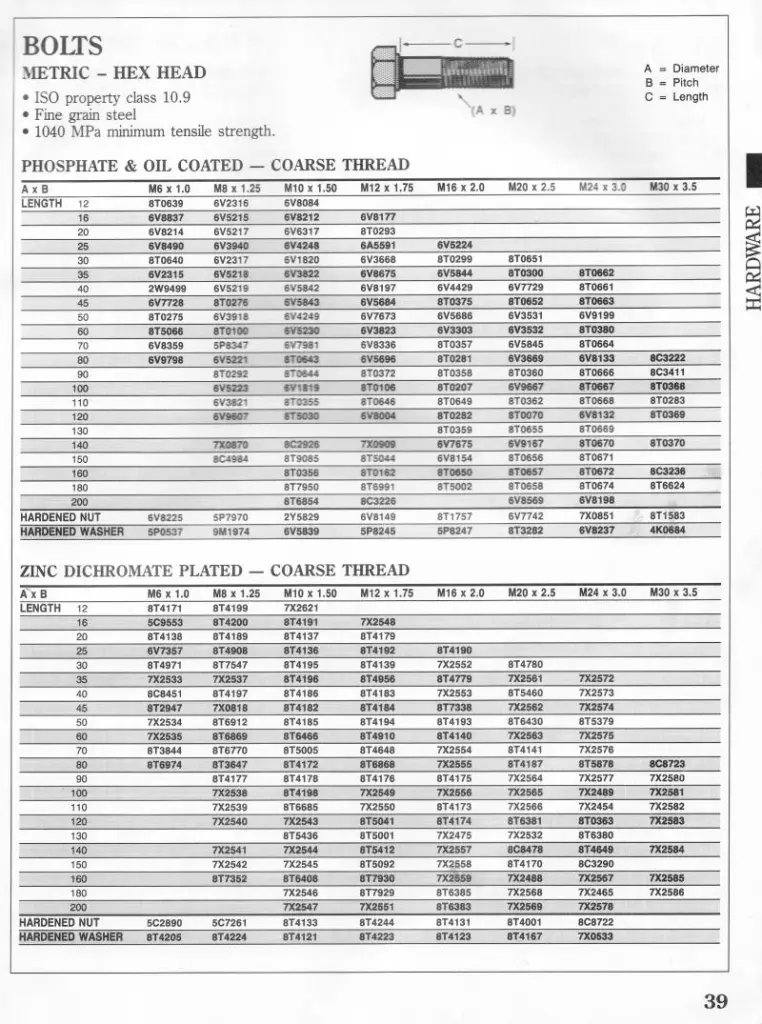

Everything you always wanted to know about Caterpillar hardware but were afraid to ask...
[attachment=57112]hdw 1.jpg[/attachment] [attachment=57113]hdw 2.jpg[/attachment] [attachment=57114]hdw 3.jpg[/attachment] [attachment=57115]hdw 4.jpg[/attachment]
[attachment=57116]hdw 5.jpg[/attachment] [attachment=57117]hdw 6.jpg[/attachment] [attachment=57118]hdw 7.jpg[/attachment] [attachment=57119]hdw 8.jpg[/attachment]
[attachment=57120]hdw 9.jpg[/attachment] [attachment=57121]hdw 10.jpg[/attachment] [attachment=57122]hdw M.jpg[/attachment] [attachment=57123]hdw MN.jpg[/attachment]
I repeated this from a earlier reply to a post.
These are from a Caterpillar "One Safe Source" catalog from the 1990's,

Hello Ray54, Caterpillar is great about keeping old P/N's on file. I use my old parts books all the time and the parts person quickly says "That number has changed been changed to..." Cat has done that for over 50 years that I know of.
I posted these pages as JPEG's so they are easy to print or view in the size you want. Cat bolts are at least grade 8 and special bolts are listed that are much stronger.
The catalog I have is 30 years old so it has P/N's for cutting edges and other G.E.T.'s that might not be listed in the new books.
I was thinking about posting more pages starting with track hardware as I find time. I am judging the responses to this post to give me incentive.

I had not tried to test print these scans and did not realize the quality was poor. I will scan them again and post them later today.
Sorry about that,

mine printed very clear once i enlarged them a little

Try these.
[attachment=57161]oss 1.jpg[/attachment] [attachment=57162]oss 2.jpg[/attachment] [attachment=57163]oss 3.jpg[/attachment] [attachment=57164]oss 4.jpg[/attachment]
[attachment=57164]oss 4.jpg[/attachment] [attachment=57165]oss 6.jpg[/attachment] [attachment=57166]oss 7.jpg[/attachment] [attachment=57167]oss 8.jpg[/attachment]
[attachment=57168]oss 9.jpg[/attachment] [attachment=57169]oss 10.jpg[/attachment] [attachment=57170]oss 11.jpg[/attachment] [attachment=57171]oss 12.jpg[/attachment]
Thanks for your patience,
Craig

Craig - looks like page 5 is a duplicate of page 4 instead of page 5. Thanks for posting this.

Thanks Cat Yellow1. The missing page...
[attachment=57174]oss 5.jpg[/attachment]

We use Cat Bolts and Hardware all the Time , Usually Cheaper than at the Local Store and of Course Higher Grade .I have a Couple of One safe source Books ,1 goes back to the sixties a chap who worked for cat in PNG gave Me . I know a Chap who Put a D8 together by Using the Cat reference Numbers. He got the D8 in Boxes from somewhere , So He refereed to the Manual and then the Parts Book to work Out the Correct Length Bolts , Big Job ,but He made it !! LJ
