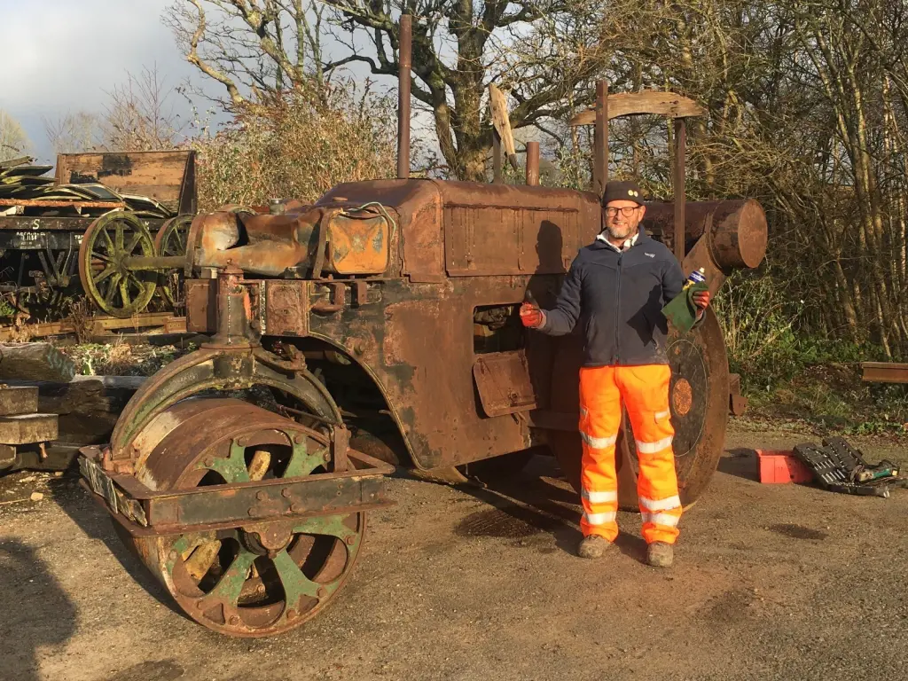

I have just acquired a 1940s Huber 8 ton three wheel road roller

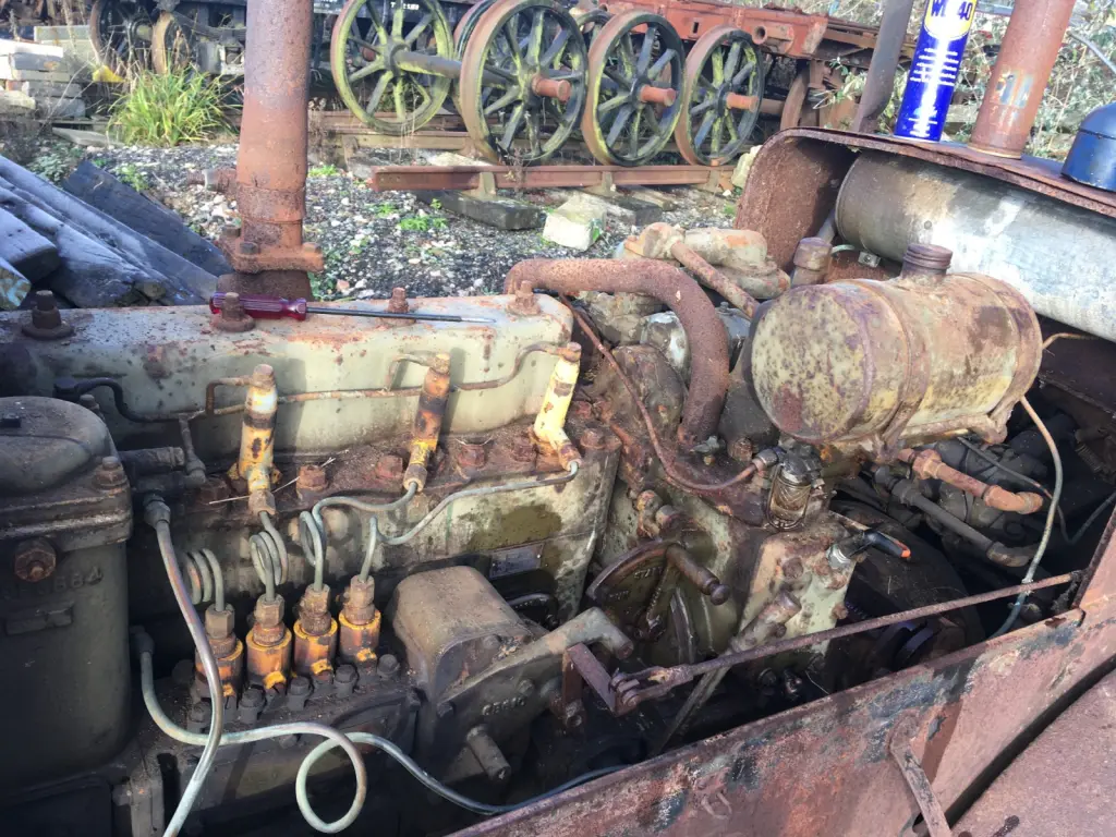

It has a Caterpillar engine, it appears to be as good as identical to a D3400 D2 engine.
I have many a question to ask about it.
The engine has a serial number tag with 1T7806SP, would anyone have any records of industrial application engines that this serial number might show up on?
Would it be appropriate to use 10W30 CAT engine oil for the crankcase and injection pump? Im in the UK so as is well known the climate always seems to be changing.
What might the SP feature be for the engine? I know there are various different SP features on the crawlers but what might it be in the engine? Uprated Horse power?

1T7XXX is just listed as D3400 engine, the SP could be many different things.

The SP on the serial no. Is normally "special parts" so could be lift pump or governor modifications or it could be different flywheel to take an an automotive style clutch, there are a few of those rollers in th UK, I think they were brought over to help build the airfields in the Second World War

1Txxxx s/n's started with 1T7001 in 1942 and were only produced until 1945. What kind of main clutch and throttle does it use. Governor looks like it might be set up for foot throttle, possibly foot clutch also. I'd stick closer to original lubes. Straight 30 wt or even 40 wt detergent in the engine and 85-90 gear oil in gear train. By chance is there a worm gear involved with the finals?
it has a hand throttle with an identical hand throttle assembly as a d2, also a hand clutch.
i had never seen a Huber roller let alone one with a cat engine before i saw this one so i really don't know much about the roller side of it.
desperately after some manuals for the roller though

i have seen many of the manuals on ebay but they all appear to be for different and newer rollers
i have been in contact with the Huber museum so fingers crossed they can find out some history on it
unfortunately the governor linkage arm has been broken off in the past and been replaced with some angle iron as can be seen in the photo
my next task is to pull the radiator, donkey engine (which does run but has a concerning amount of end play which will need to be addressed) and then pull the main engine
