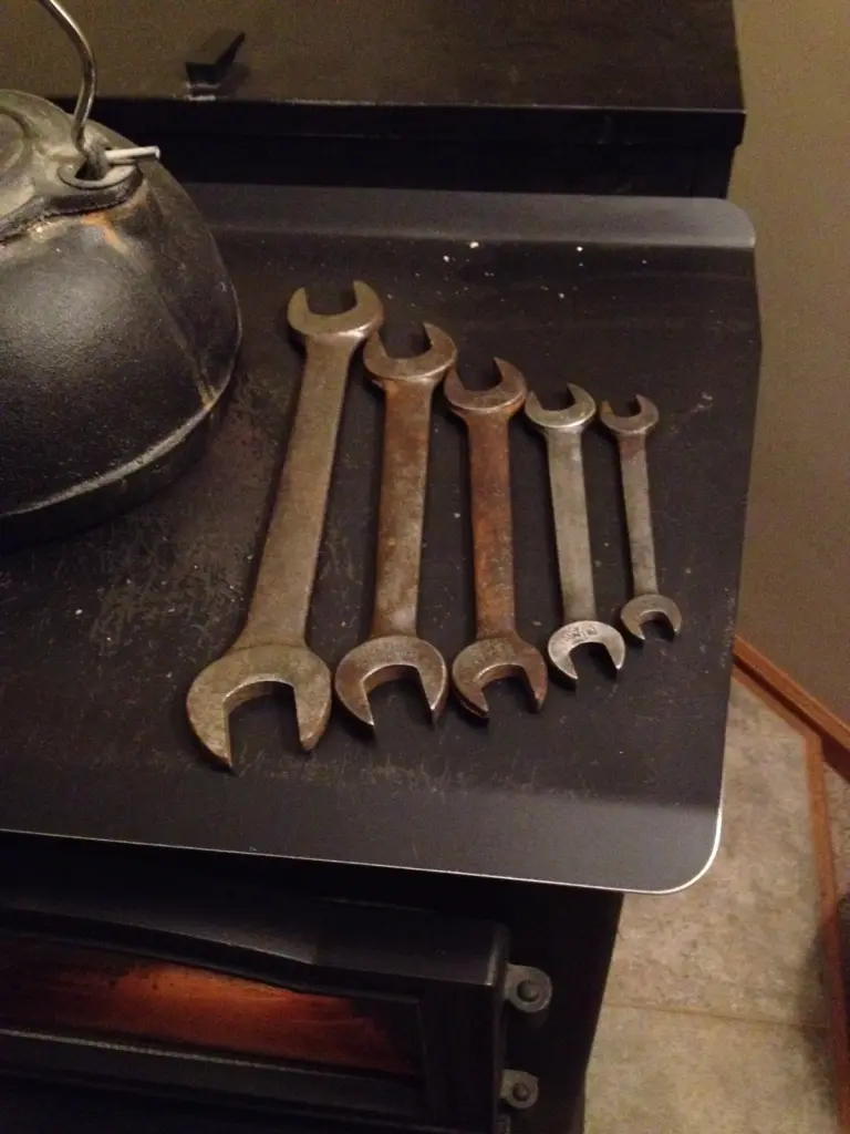

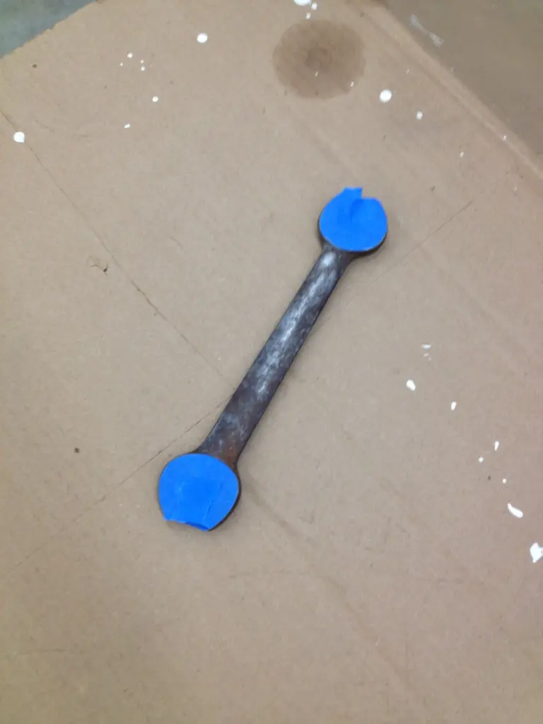

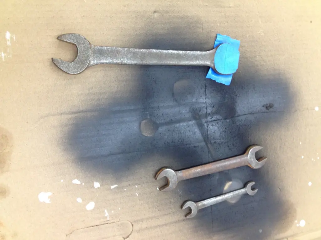

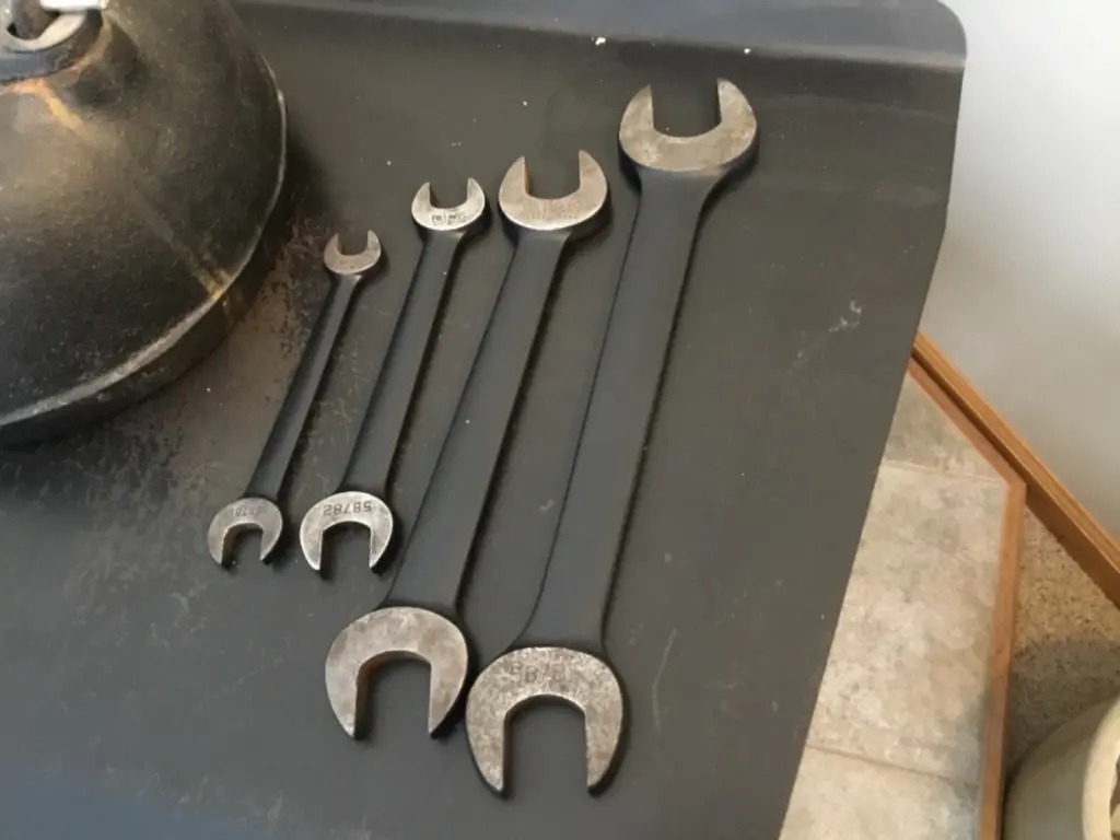

I have a handful of Billings wrenches that had been through the wire wheel before I took possession of them therefore the crackle finish on the body was long gone. I decided to give them some attention today. I cleaned them up and taped the faces off then dusted with black primer followed by black textured finish. Here are the before photos. [attachment=61809]B1D1D229-AE08-4304-8BE2-EC12575D9314.jpeg[/attachment] [attachment=61810]EE0CA55A-2A2E-4814-B747-CA80ED23CCF8.jpeg[/attachment] [attachment=61811]C365FADE-A64C-4A5F-98AA-C5F749DDC999.jpeg[/attachment]

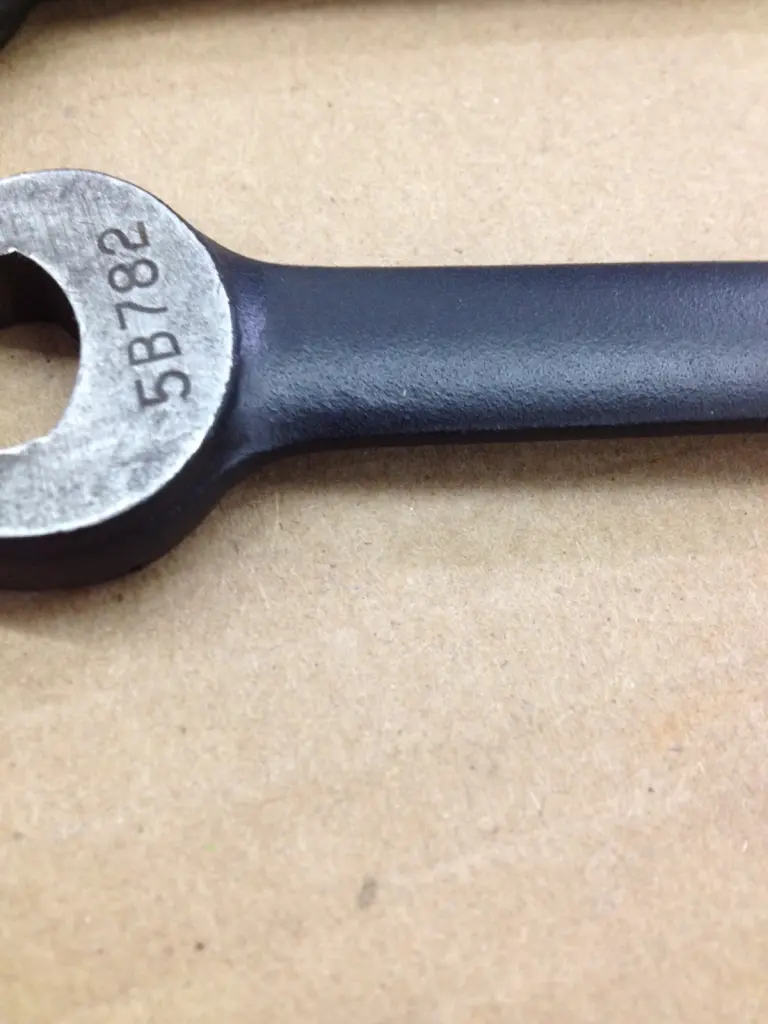

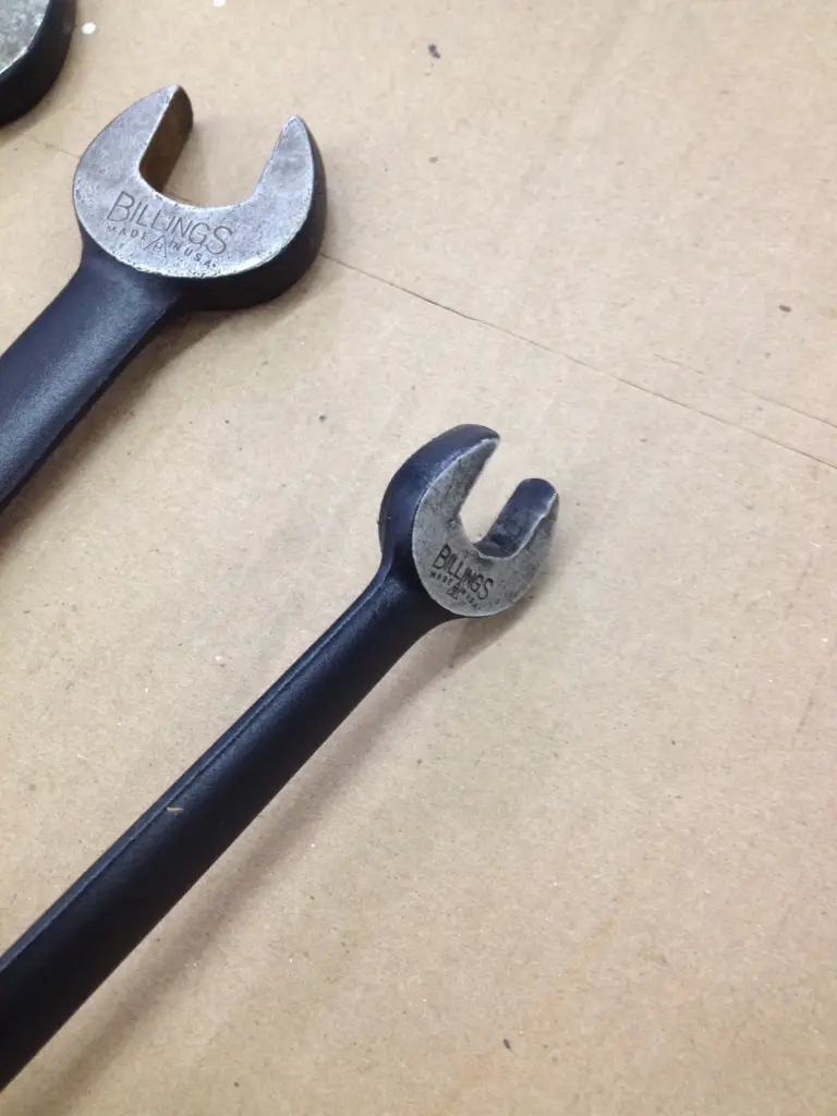

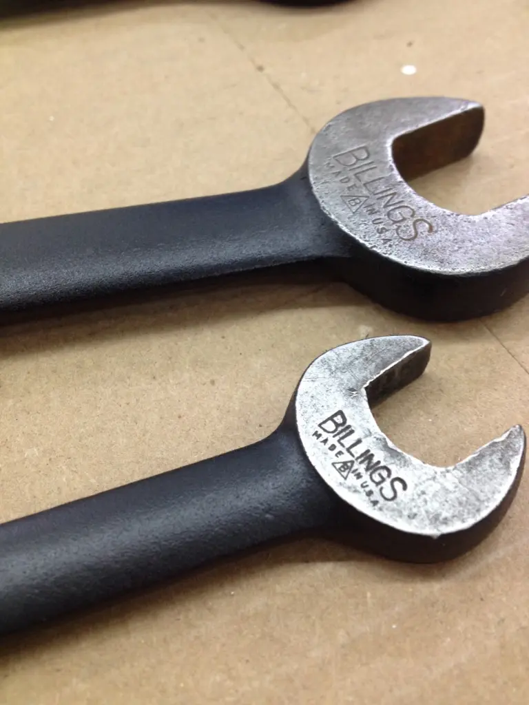

Here they are after paint.
[attachment=61816]84D3D2FE-4A0C-43B8-852B-0BB89C4A6719.jpeg[/attachment] [attachment=61817]ED704297-8B9B-40F1-BE9A-AB07FFD61C84.jpeg[/attachment] [attachment=61818]8BE9546F-4D30-44F1-9FA5-C4A98D44B3C1.jpeg[/attachment] [attachment=61819]B9957248-2C39-4F2F-A363-8BE9B86E32EF.jpeg[/attachment]

Hi, Seyser.
Neat job. They look pretty much straight off the shelf. Thanks for sharing.
