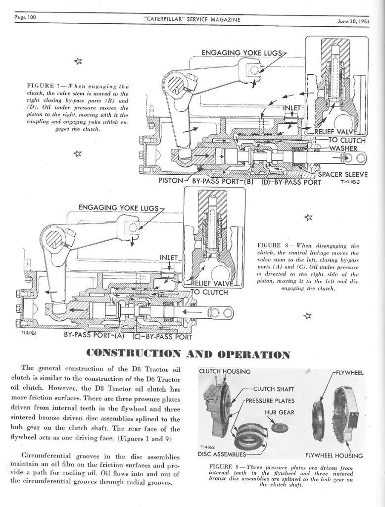

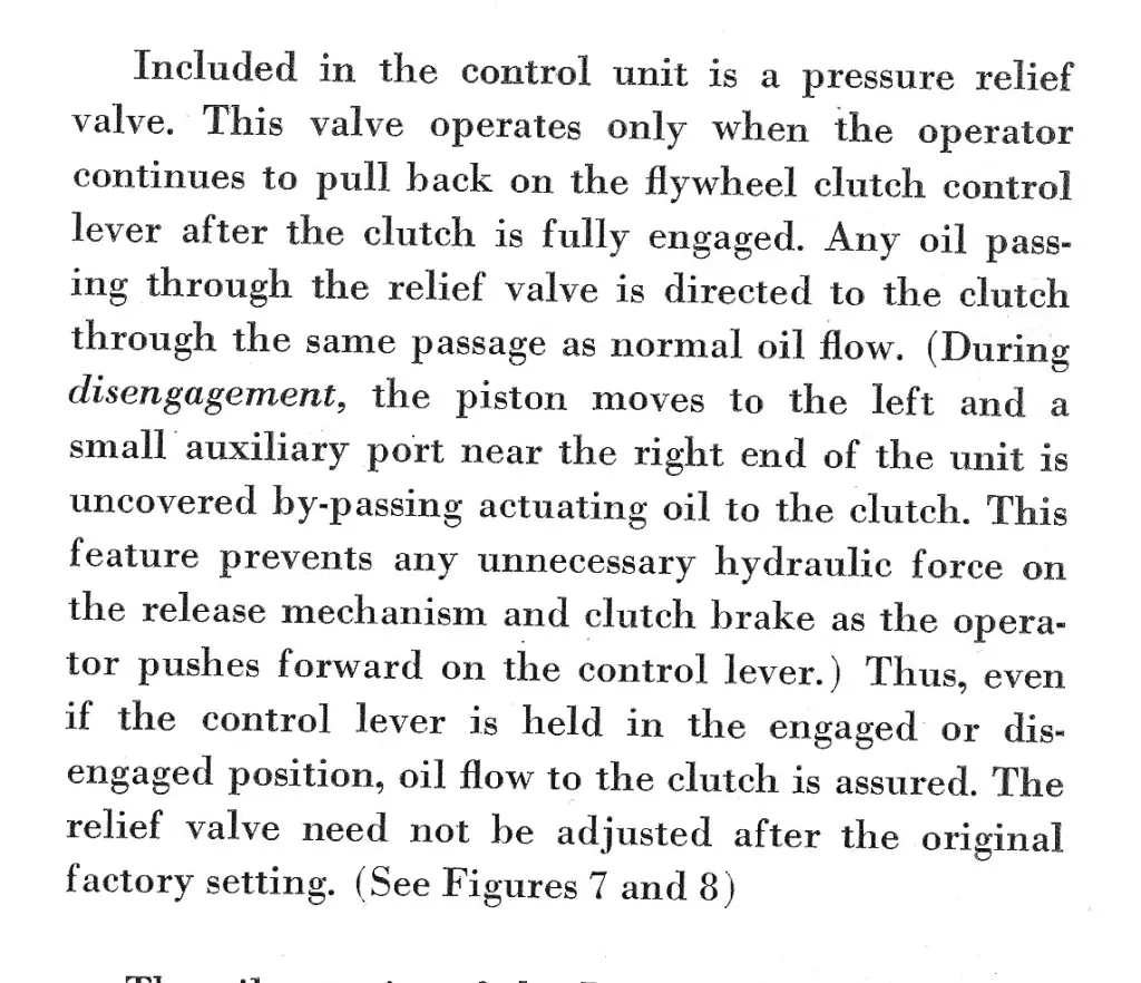

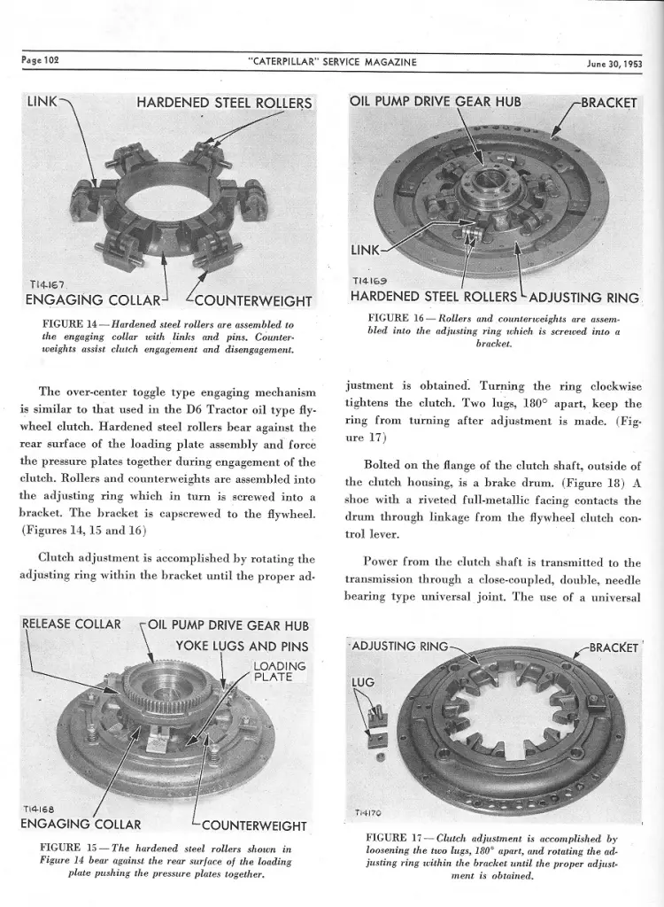

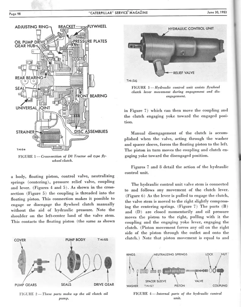

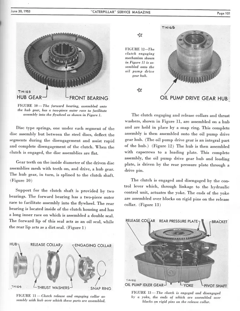

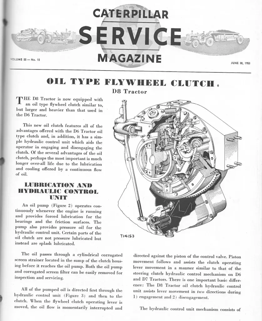

your assumptions above appear correct as per the descriptions detailed in the Construction and Operation section in the scans below.
Yes, the clutch stays clamped/engaged by vitue of the cam over centre action of the links, rollers, and counterweights as is the normal way Cat uses to operate and clamp their clutches in most model machines. The hydraulic cylinder is only a booster used during engagement and disengagement of the clutch assembly.
Here are the scans of the Service Magazine June 30 1953 detailing the new D8 Oil Clutch and its operation.
First excerpt scan is what I tried to explain above and is from page 5 of the series, right hand side of page between the photos.
Hope this helps.
