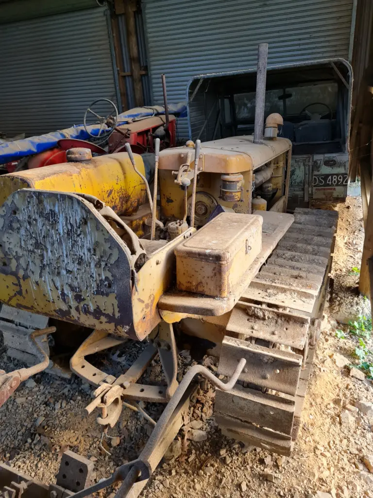

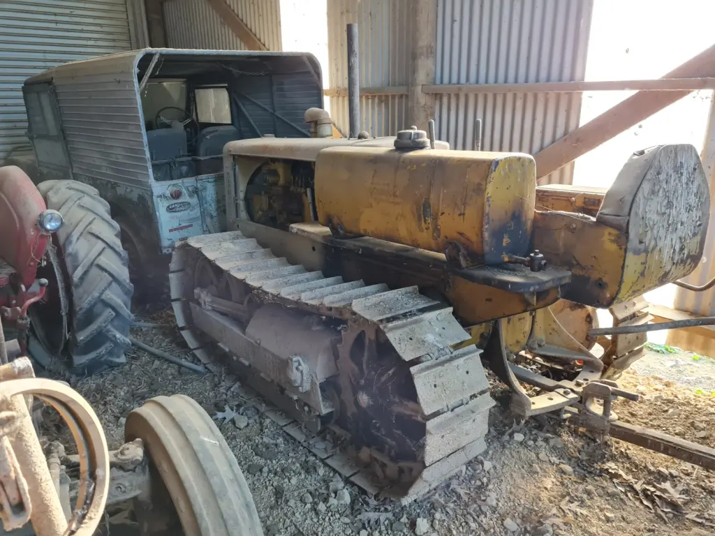

Well, I was chatting to an 87 year old 3rd generation landowner and farmer here in NZ on Saturday about D2's and he said, 'I've got one'! Turns out that it is a 1940 5J purchased new by his father during WW2 and used for breaking in virgin hill country here right adjacent to where I live. It's not for sale but I thought it would be interesting to show, and also be added to Chrisco's serial number list as it's a matching number machine, very well used (nearly 12,000hrs) but very original.
 [attachment=62909]20210417_154214.jpg[/attachment] [attachment=62906]20210417_154016.jpg[/attachment] [attachment=62908]20210417_154433.jpg[/attachment] [attachment=62905]20210417_154331.jpg[/attachment] [attachment=62907]20210417_155048.jpg[/attachment]

What a beauty Mark. Doesn't look like he uses it much. The paint on it is superb - aged but not overly rusty. That radiator shroud is just about the best non-restored one I've ever seen, including unrestored ones that have unfortunately been polished. I like the Series I LandRover in front of it too. That's a bit older than Dad's, based on the number plate. Dad's is a '58 I believe with a number plate starting with ESnnnn. I'd like to buy it off his estate but I"m not sure if I can afford it, given the price of old clunkers these days. Maybe I'll just have to take out a mortgage! Is this down by the one in Gore?

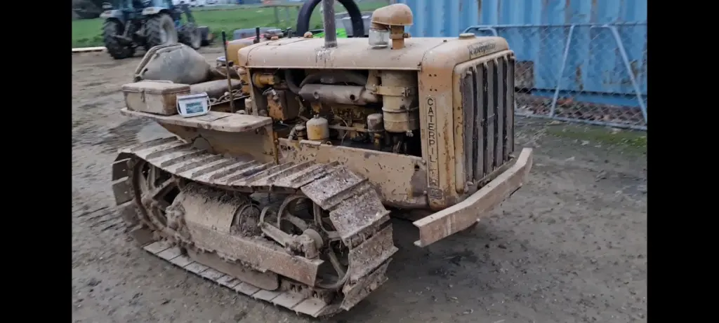

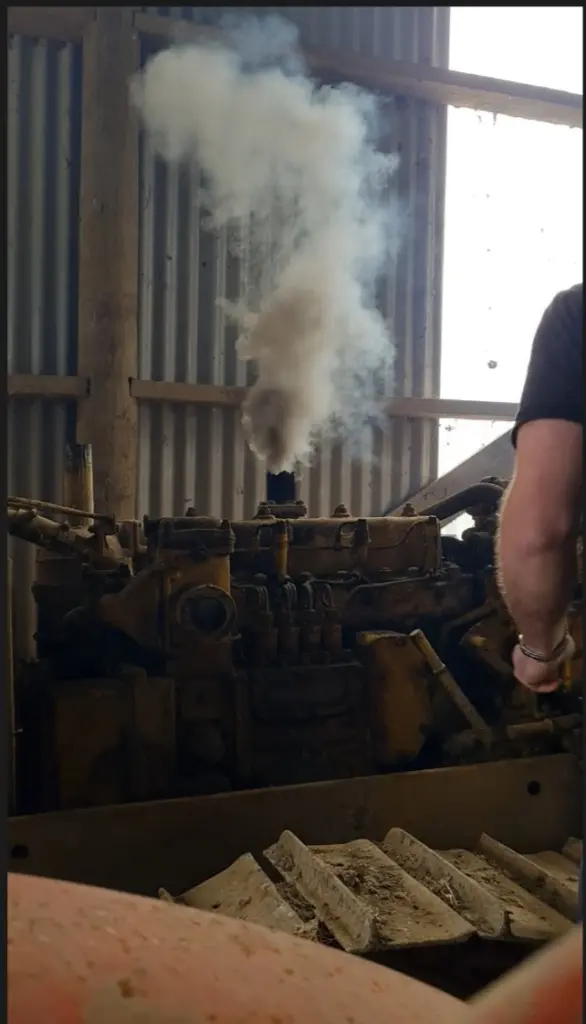

What little time I have had over the past couple of weekends has been spent working on getting this old 5J running and on Saturday I had success! I have rebuilt the old Eisemann RC-2 Mag (new condenser - adapted from an Iron Horse lawnmower! And cleaned and set the points) and I also removed and cleaned out the carby on the pony. I had to adjust the pinion clutch and still need to adjust the pinion catches as it won't stay engaged without holding up on the engagement lever. Otherwise, the pony starts and runs amazingly well (first pull) and the diesel runs beautifully with great oil pressure. The main clutch, steering clutches and brakes work perfectly too which is a bonus! I took some videos, which I will try and upload, but for a start, a couple of stills from the said videos will have to do.
  [attachment=63681]Screenshot_20210617-115719_Video Editor.jpg[/attachment][attachment=63682]Screenshot_20210617-115316_Gallery.jpg[/attachment][attachment=63683]Screenshot_20210617-115338_Gallery.jpg[/attachment]

Well done Mark! I have to say they don't normally go that easily : ) but you got it done. I'm looking forward to the video

Great result, that's the best time, seeing and hearing a long dead Cat firing up for the first time, enjoy giving her a good flogging pulling something appropriate now!
