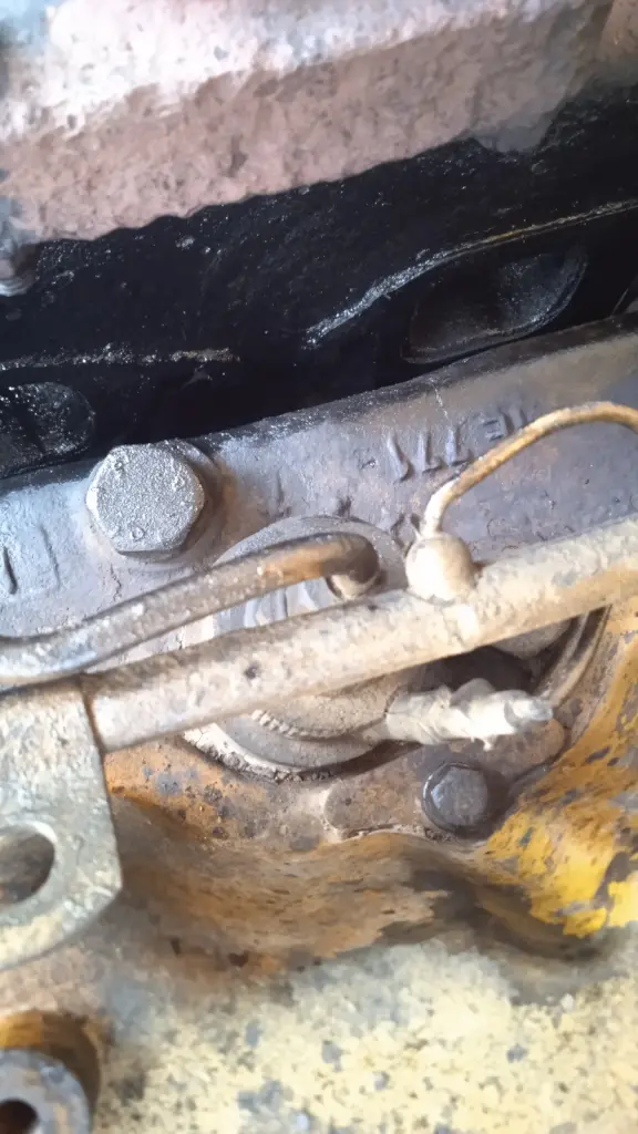

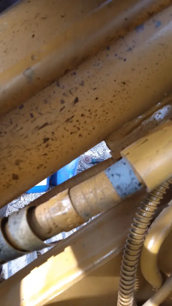

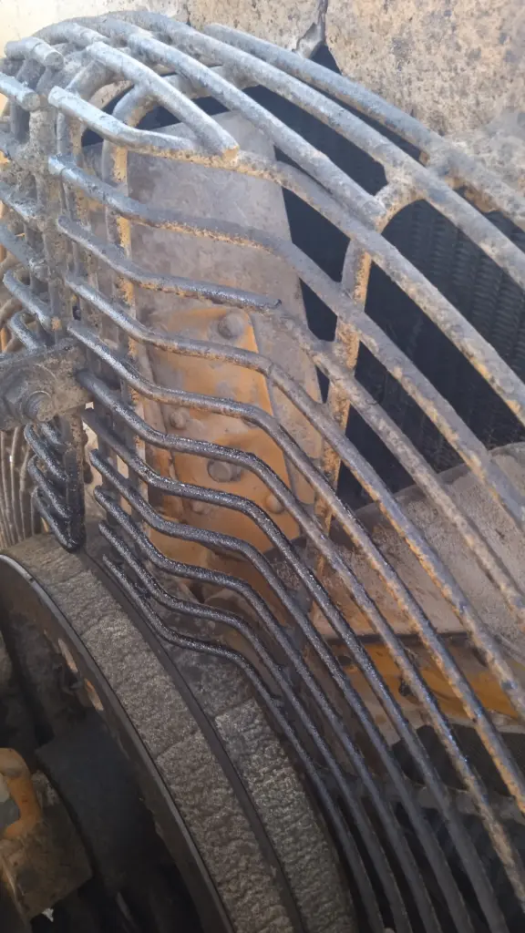

I am attaching images.
I ran the engine on max for 1 hour.
has dirtied everything ..
oil comes out of all cylinders.
all this oil possible?
all piston rings damaged?
possible valve guide?
I am desperate...

I'd say she's do for an overhaul, had a D315 do that, needed rings and sleeves.
why it stops smoking is heat it is burning the oil. also the leak may slow as seals warm up and become more supple and oil rings expand etc.
the best fix is fully rebuild it half measures dont work too well and since you have to pull half of it apart to do a half job a full job isnt much more work it just costs more money.
side note if you do a full engine job you know the engine is right cuase you service the radiator too.
Hi Team,
check both the inner and outer air cleaner elements for restriction too as clogged air cleaners can cause oil to be drawn up past the rings.
Sometimes if an engine has run backwards (reverse rotation) the soot from the inlet (now exhaust) clogs the inner air cleaner element and is not seen without removing the element to inspect it..
I assume you mean by 1/2 of a millimeter valve movement that you mean the valve lash clearance and not the total opening dimension as valves only just opening can cause strange things like excess suction in the cylinder and oil to be drawn up past the rings.
Valve lash clearance for these engines should be :-
Inlet = 0.38mm (0.015")
Exhaust = 0.64mm (0.025")
Wrong weight/grade of oil or fuel diluted oil can cause such oil usage too. Fuel dilution can be caused by failed fuel transfer pump shaft seals. Seals can fail if the supply line and or the primary supply screens from the tank restricted. Some fuel tank taps have a screen in the fuel entry into the tap--can only be seen when the fuel is drained from the tank and the tap removed to inspect the screen--you parts book should show where the supply screens are as well as the Operation and Service Book
Poor quality fuel can also not fully burn and so come out the exhaust too ---I have encountered this with faulty fuel that will not burn fully from the supplier.
Just some things to check before spending big money.
