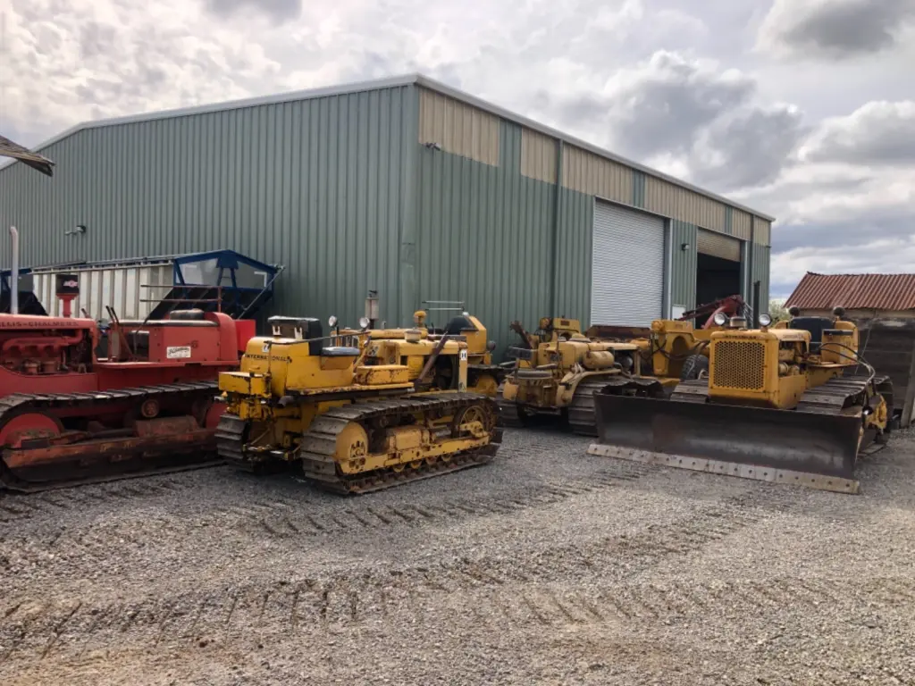

Hi Juiceman, nice picture of part of your "fleet"

I ended up moving several out of the old shed just to be able to get the 9U out. Yikes! Good time as any to fire some off and circulate the oil, etc. The dozer will likely go to a new home in Sonoma County. I need to thin the herd just a bit. Thank you Angelo. JM
