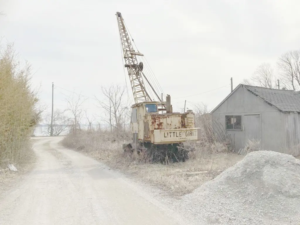

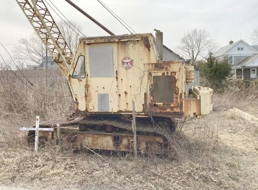

I realize [attachment=65827]Little Giant C32.jpg[/attachment] [attachment=65828]little giant.jpg[/attachment] this is not mainstream Caterpillar talk. There is a 1987 Little Giant C32 crawler crane that I am interested in. The machine is easy to get to. The problem is that supposedly it will not walk. I am looking for any information, books, literature and or personal knowledge for such. I do collect other orphans of unique interest.
Thanks for your time in reading this. Help a collector with bad iron deficiency!

Detroit 4-53 with mech. over center clutch. Supposedly the machine will not travel, I am thinking it got to where it is. So?? Trying get more info before I go down to see it. I know I am bringing fuel and a hot battery ! More road trips and old iron !

you need to determine if it is an independent swing and travel machine or if the swing clutches are used to travel the machine. my guess if with the dozer type undercarriage that the swing and travel are independent from one another. could just be a rusty frozen linkage or dog clutch.

before you try to start it you should prepare for a runaway by having a board to cover the air intake. look at the levers or air controls, there should be a swing lever a crowd lever and a hoist lever,sometimes the hoist lever doubles as a boom lift also unles it has a live boom. if there is another then the chance that it has independent travel is high. find the main clutch lever ans once you get it started and build air pressure just feather the levers until you figure out what lever does what. if the travel and swing are tied together there will be a nother lever probably below ant to your right that lifts a dog clutch that sends power from the swing clutches down the center to the bottom.  take some pics of the controls??? and the works?
