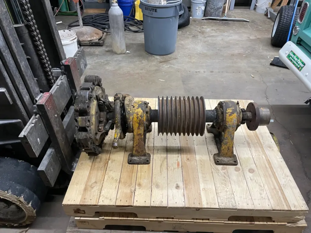

 [attachment=66957]78AF0723-ABBD-45C0-A360-ABDCDE80196A.jpeg[/attachment] [attachment=66957]78AF0723-ABBD-45C0-A360-ABDCDE80196A.jpeg[/attachment]Hello All: I have a 1948 d318 stationary engine powering my sawmill. It has an overcenter clutch with a large diameter shaft that I know rides in a pilot bearing in the flywheel, then must be splined to fiction plate then goes thru the "throw-out" bushing(actuated by lever) then goes thru two pillow bearings on either side of the drive pulley. The bearings bolt thru the main frame of the powerhead. I need to rebuild the two bearing as they are growling and getting hot. Does anyone know if the whole assembly will just slide out of the flywheel/clutch without taking the clutch apart? I tried pulling the shaft away from the motor but it does not move. I will try to post some pics of what I got. Tx

Clutch cover has to come off and the whole clutch and shaft comes out as an assembly. (Big nut on the inner end holds it all together).
According to my parts book the clutch and pillow block arrangement does not use a pilot bearing in the flywheel.

 [attachment=66964]74AD324C-7F46-48BB-9727-024A80A39317.jpeg[/attachment]Thank you. Yes whole assembly is captured by 6 cotter pins thru 6 pins that are part of flywheel. The bearings are self aligning double row ball bearings-now skf 2312… cost $500/pop but applied industrial assured me these are not made in the far east
