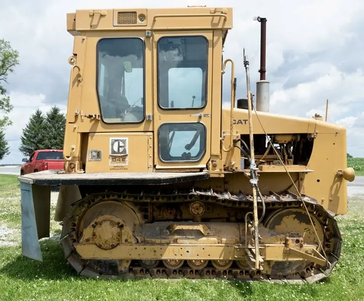

As I mentioned initially I'm almost 100% certain this one has spent it's life on a potato farm. I've seen in the field a few times over the years.
Best I can tell it's just the standard 96hp, not the 140hp turbo type. Looks to have three hydraulic remotes. No pto or 3 point.
The only price reference I can find us a couple the Zimmerman has listed. Both of those are 140hp, and one has a brand new undercarriage. I'd venture a new uc alone is close to $10k these days.
I've been in touch with the seller and plan to check it out next week. [attachment=68241]66D83A6A-54FC-4087-83B8-CD5147D5E854.jpeg[/attachment][attachment=68242]41576497-802D-4A8A-AB1C-51F8AF2DD8BB.jpeg[/attachment]

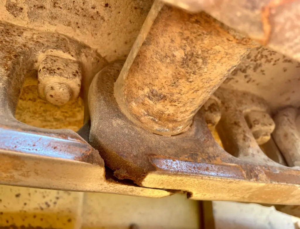

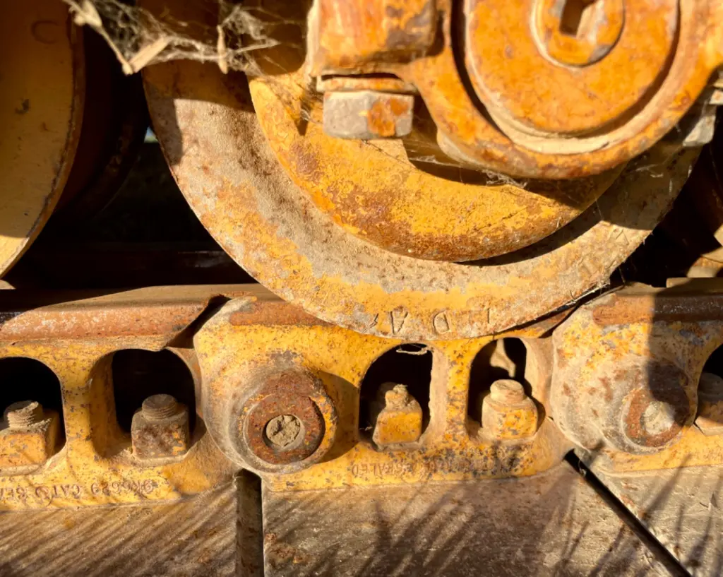

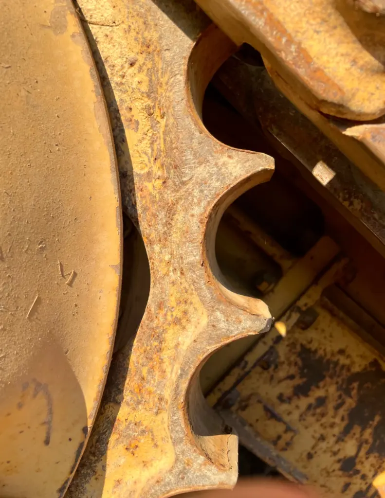

I've been mulling over the tractor a bit. Still not convinced it's worth the asking price.
As it so happens I noticed the crawler sitting out with a for sale sign when I was heading into town for an appointment. On my way out of town I stopped for a couple minutes to look it over again and take a few pictures.
Looking it over this time it looks to me like there is some considerable wear on the track bushings. There again I'm not a particularly good judge of such. In my ignorance am I correct to assume that sealed tracks are run to failure, as in there's no turning the pins and bushings?
