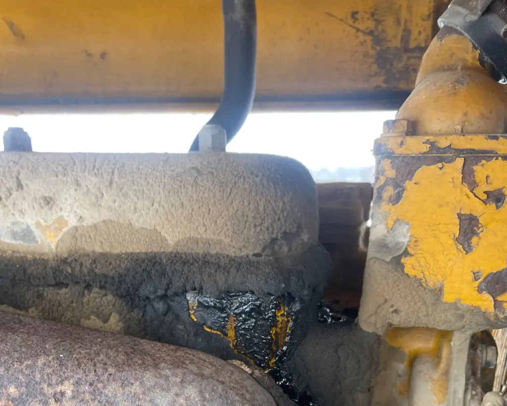

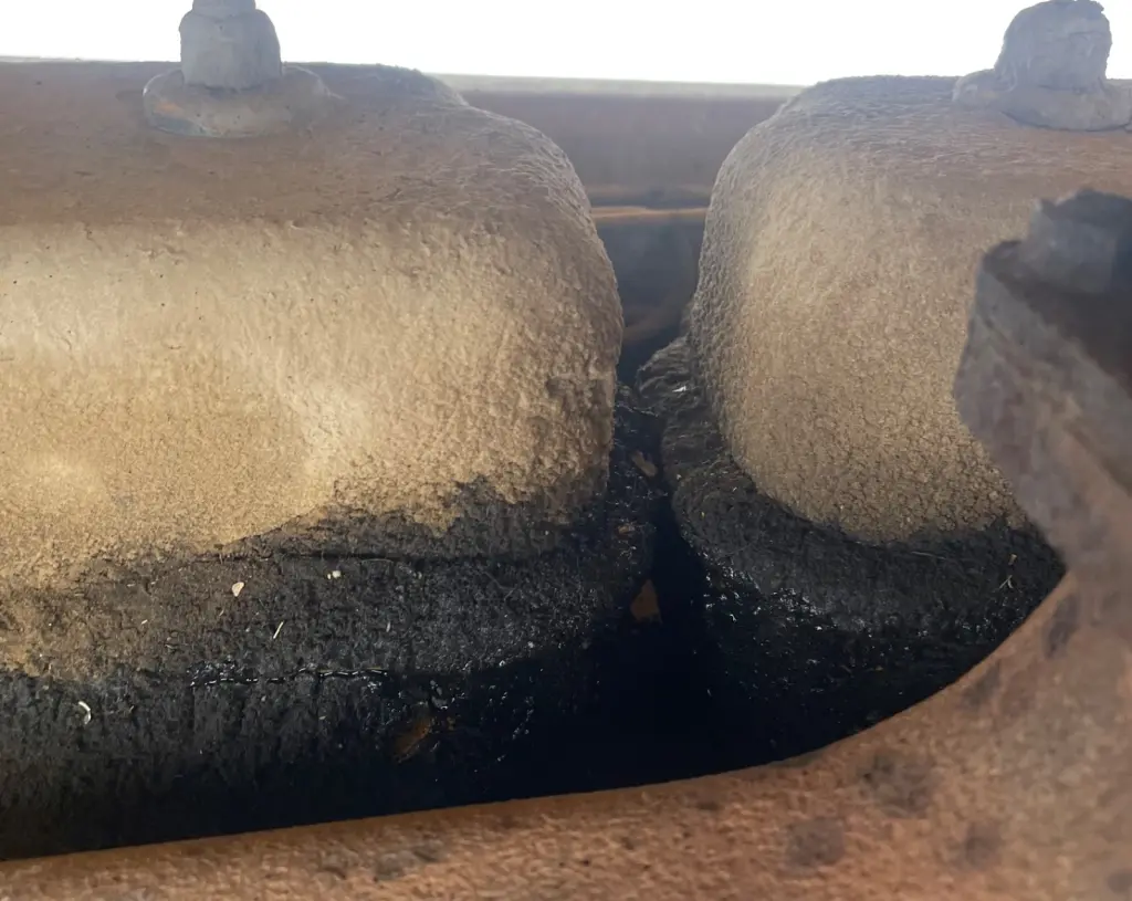

Second question as you can see in the pictures it is spewing oil from around the valve covers. The gaskets were changed a couple of times back in the day at least that is what my father remembers but unsure. He seems to think the valve covers were warped but I’m not sure.

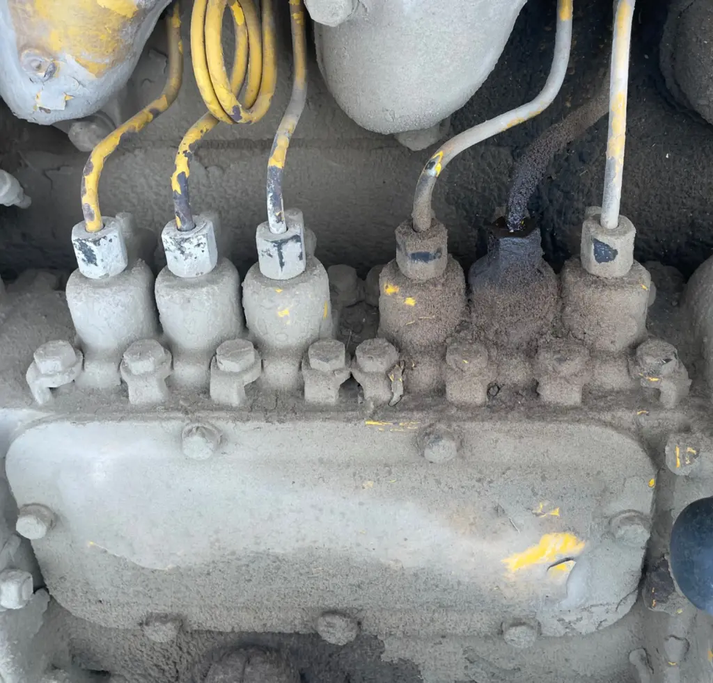

Last question for now. It has a miss in the number 5 cylinder at least I believe that is the one. When you loosen the fuel line at the injector pump it tends to disappear. Hopefully my videos we load and be clear enough(okay I need to figure out how to compress or just take audio). My question is am I looking at rebuilding injectors? Or replacing injector pumps?

I have had valve covers on the D318 engine ( what is in your D6) that where warped. I think I got them flattened enough to stop leaking with a new gasket. But I may have used a different set finally. I have always had better luck by tightening them just a little at time.
I have replaced injector nozzles when I have had one cylinder missing, but never a pump yet in 40 years. But who knows how much better they might run with rebuilt pumps. I think the "new cleaner fuel" will cause more trouble with gumming and rusting than the old fuel with sulfur in it ever did.

Looks like 1956 per https://chriscomachinery.com/caterpillar-machinery/#caterpillar-model-d6. If your rocker covers are warped, you can try to reset them by first setting them on a flat surface and looking for which corner is sticking up. Determine how much it's sticking up, then place a block twice that height under the adjacent corner and press evenly across the top so that the high corner touches down on your flat surface, then reassess the warp. If you can't get it to within say 10-20 thousandths, then you can find used replacements no problem. Also check that the flange isn't actually cracked - good excuse to clean the covers off thoroughly, but do clean around the parting line first so that crud doesn't get into the rocker compartment. For your injector, does the injection pump seem to pump a similar (eyeball) volume per squirt? If not, then you might have a stuck pump although that wouldn't tend to change the sound of the engine. If it does pump evenly, and since when you loosen the line, the engine sound changes, I suspect your injection valve is faulty. I believe you can get new nozzles for the valve pretty easily, if they're anything like the D2 nozzles. Someone on here will know.

Clean that machine up around the valve covers, fuel pump, filter tower, etc - in short anywhere that dirt and grunge can enter the engine. DIRT IS THE ENEMY when working on machinery.
After you have gotten the "grunge and grime" off you can determine where the leaks are and a suitable fix.
There are many products out there now that will cover large gaps and take temperature too. The advent of silicone type sealants has changed everything as we knew it.
Neil is correct - find out which corner is bent and if the flanges are indeed cracked.
Cracking an injector line at the pump (bleeding the fuel off) will cause a missfire - the injector does not get the fuel. If that is indeed what you are doing and it makes no difference in the engine sound, you have found the cylinder that is the problem child. Try each injector line, one at a time and compare the "squirts" of fuel as you run through them.
They should be pretty even. Keep your skin and eyes protected, that fuel is under high pressure leaving the pump.

for most gaskets a dressing i use is loctite aviation n03 form a gasket they also have hardening one that is a paste and a non hardening paste.
there is also "stag" jointing paste its hard setting designed primarily for pipe fitting but also works on gasketing (dad used heaps of it doing water bore and irrigation pump work)
loctite also make a couple of anerobic gasket makers i use 515 master gasket a fair bit too it can be used as a dressing or on its own.
a word of warning about rtv silicones only apply the amount needed any excess squeezes out and goes places you dont want like oil galleries cuasing problems. and often much superior products are available.

any good injection shop should be able to rebuild those pumps and injectors for you. and yes todays fuel doesnt lube the same as the old fuel did so a diesel fuel conditioner is helpful. i use flash-lube's product in our equipment works out pretty cheap insurance as 5 litres will treat a thousand gallons since the mix rate is 1 ml per litre of fuel.
