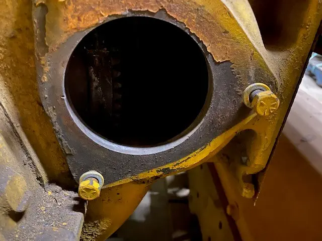

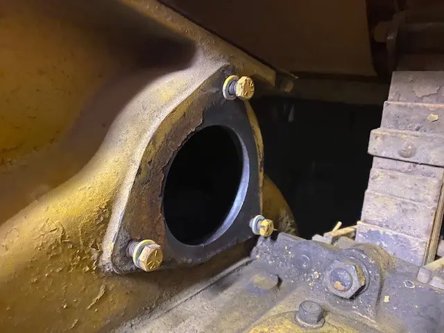

Thank You for your replies....it looks like SAE#1 with an offset judging from what I can see...I have a attached a couple of pictures, and if you look closely you can see the ring gear is quite far over towards the block. Hoping you can see the pictures ok? [attachment=71439]R2 Starter Mount.jpg[/attachment][attachment=71440]R2 Starter Mount 2.jpg[/attachment]
That looks to be an SAE #3 mounting. Bolt C-C spacing should be 5".

So Just went to the shop and measured...you are correct 5" C.C. with 1/2" NC mounting holes, pilot looks to measure 3.6" with calipers, and it is Definitely straight cut flywheel. I had a 39MT Starter for another project, which I tried it does mount up, but it has a 12 tooth pinion. Might have to play with pinion sizes to get the right combination.
