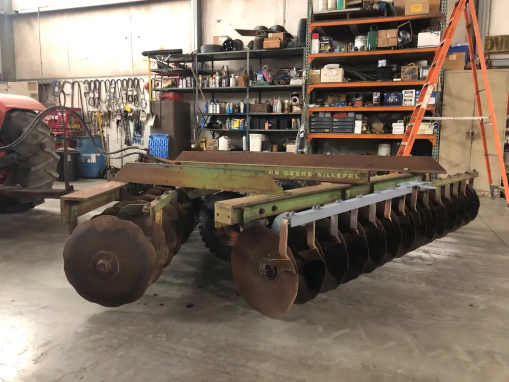

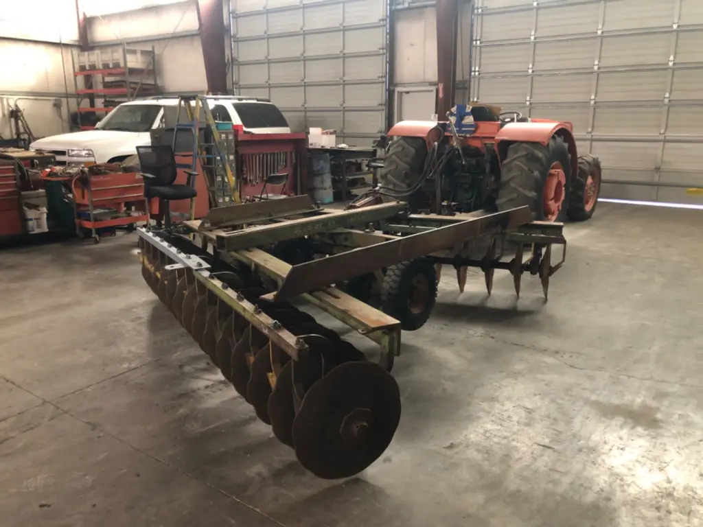

 [attachment=71553]8D96A72E-57EE-4A4F-9DA9-40384BE03736.jpeg[/attachment]Just started a restoration on a Killefer 206x disc to pull with my D2. Looks to be in decent shape for a 1949 model. We have it torn down and the bearings seem ok, I know those are some hard items to get if you need them. I do need some scrapers for the front gangs. Two were missing. I could also use a picture of the right hand turn chain drawbar for a D2. This would trip the disk when making right turns so it wouldn’t dig a ridge. Any advice on this disc is appreciated as well.

Neat! Many Killefer parts are obsolete. The scrapers you could try your hand at some blacksmithing and bend your own. Some folks install a smaller diameter blade on the outside, as it would throw less dirt, depending on how offset your front/rear gangs are. The turning bar you are referring to, I do not have photos in my phone. I might be able to take some pictures for you later. Perhaps you will get lucky and someone will beat me to it.
Cleaning of the cast bearings I like to use a needle scaler to break free the crud and dried grease. Keep us posted with updates. Thanks, JM

Project -- Wow - you have your work cut out for yourself! That disc has seen more than a little wear, maybe some abuse too!
As JM said, you can form scraper blades, that would be one of the easier tasks ahead of you.
Depending upon the condition of the bearing castings and axle shafts, rest should be obtainable, even new blades.
Right turns with a disc were always considered a NO-NO -- even closed up which the bar mechanism was doing introduces strain on the blades.
Without closing the disc, you are more likely to break blades, bearings, etc.
When discing - I was always taught to avoid making more dead furrows than necessary. Thus you always started your first pass next to each other and worked outward.
In large fields - we used "lands" - picking a very distant point to try to keep the tractor pointed in straight line.
Dead furrows are created when the rear gang's outside blade pulls the dirt back, nothing to fill that depression. Sometimes a section of spike tooth harrow was pulled behind the disc or in many cases a "cultipacker" roller. Even a piece of RR track with a chain holding it across the width of the disc helped break up clods and fill the dead furrow.

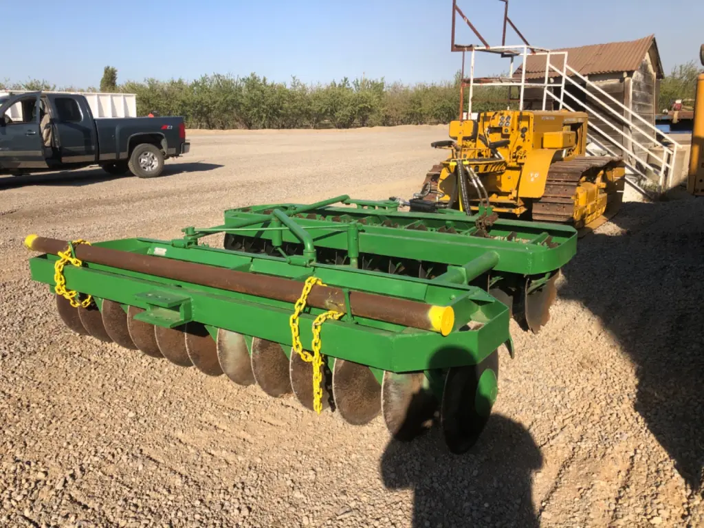

Oooh neat. That would be a 6' drag type with hydraulic opener, and replaceable bearings.
I have some 1115 along with 1200 series in 8',10',12'15',18' and 21'. Just finished with an HD-10 wheel disk too.
I bought a trashed 1109 to glean some scraper parts from it. JM

I wished I knew sooner hahahah. I had to liberate some scrapers to finish out this HD-10 Killefer I bought last month.
