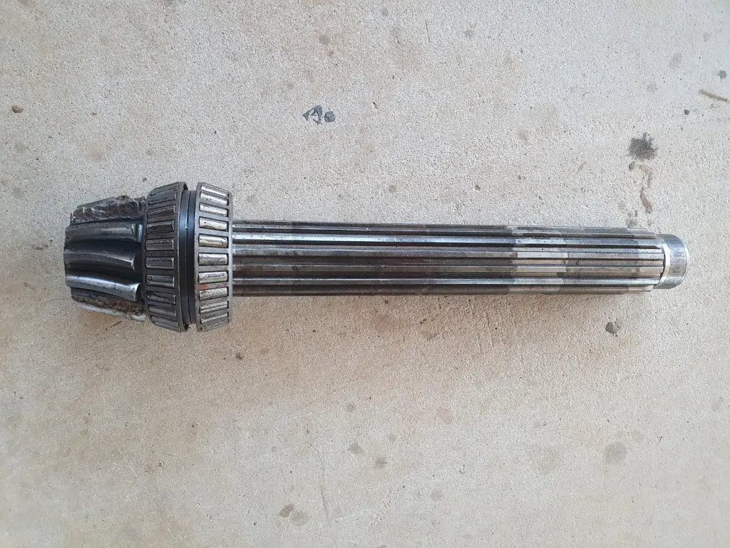

Hi, I’m in Australia and I have a D4 30A, No.0168. I have the transmission stripped down, and I have found the shaft that drives through to the steering clutch crown wheel(12 tooth shaft & bevel pinion) is very sad. I have a parts book for D4 serial numbers 4G1 to 4G9999, a parts book for serial numbers 7J5104to 7J9999, 2T1 to 2T9999 inclusive, and a parts book for D4 60 inch gauge serial numbers 40A1 – up.All the parts books show different part numbers for the shafts. The only one that seems to match what my shaft looks like is the 40A. By match, I mean my shaft has the double race bearing assembly and all the others have a single race ball bearing on the bevel gear end. The 40A parts book number for the shaft is 9H6980. I have attached a picture from the 40A book and a photo of the shaft from my transmission.What I would appreciate is if anyone can confirm that my 30A does have the same shaft as a 40A? I am a bit reluctant to purchase the shaft with out knowing a bit more. Tilly's in Australia are unable to confirm this for me, although they do show that part number shaft in their system as a 955.
Any help would be really appreciated.
Thanks,
John [attachment=77997]20241024_105129 - Copy.jpg[/attachment] [attachment=77997]20241024_105129 - Copy.jpg[/attachment]

Hi John, Cat made a retrofit field double roller bearing upgrade for D2s that had a single row ball bearing. Perhaps that's what was done for the D4 as well? It included the bearing race housing as well, in the upgrade assembly.
Wed, Oct 30, 2024 7:17 PM
Posts: 16,757
Thank you received: 39
Yes, appears you have the upgrade pinion assembly. It is not the same as used in the 40A.
Standard pinion was used on 7J5248-up, 2T, 5T, 6u-1-10362, 7U1-29733 (pinion # 8B4394).
Your 30A is the same as the above models.
The standard 955, 12A1-8097 and 26A1-127 uses a different gear and pinion.
The 3H6261 pinion is installed on 6U10363-up and 7U29734-up and was also an upgrade to the 12A1-8097
 [attachment=77999]D4-Pinion-Upgrade.jpg[/attachment]
Thanks very much for the information. It's good in that I now have a part number to search for, and bad in that they do seem to be a little hard to get hold of. I do have an older D46U that I will strip down to see if it is the same, but my gut feel is, it will not be the upgraded pinion.
I'll post what I find.
Thanks again.
