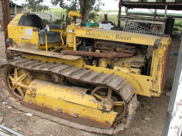

I added another kitty to the fleet today... D2 5U183xx... placed into service in April 1957 working in the orchards in the San Joaquin Valley of California.
Its my first factory equipped direct electric start with glow plugs...
I have two questions: how does one test each glow plug to insure that its operating as designed ??? ( the amp gauge does show a healthy discharge when activating the pre-heat switch )
How long should I have to heat the glow plugs before starting the engine when the ambient temp is 40 to 50 degrees F ???
Thanks, Wayne

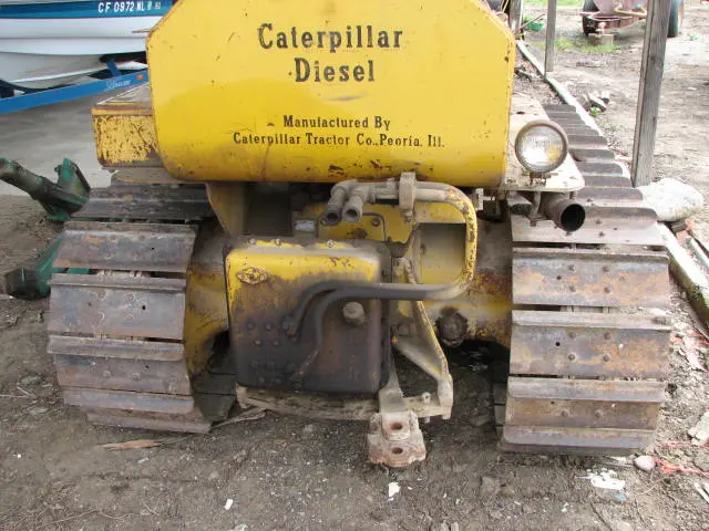

Nice tractor. It also has the rear #41 Hydraulic unit.

Nice Ride Wayne! Very straight tractor. I have to ask what the two little fittting looking thingies located under the battery disconnect switch on the firewall are? I have never seen a Cat 41 pump on the rear of a D2 so that picture was very illustrative.

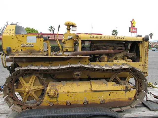

I noticed that in one of your pictures, that after you run your cat a while you can cook your lunch on the fender😊
