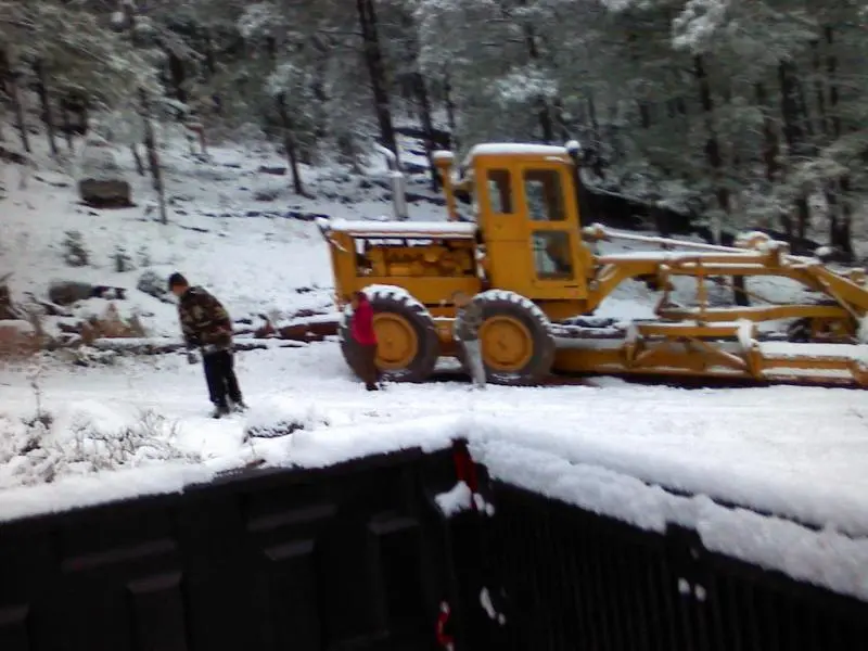

I recently acquired a 12'Cat Moto Grader.The Pony motor has a wiring problem, and I was considering a conversion to electric start.I haven't been able to find out what,year,or mod. this is.The only tag that I found on it, was one with this stamped on it; CAT CHILE.M.R. 8T6465. Can any one possibly help me in finding out what I have?Thanks much....

Your 12 grador serie is 8t6465 with d318 motor

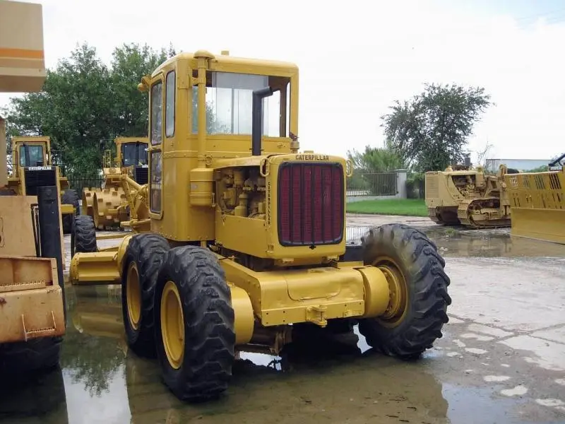

These photos might be of some interest...Found these photos of a CAT112 Electric Start Conversion...The back view is just showing how the battery mounted to the frame...The side view is good for the starter mount...I've got a CAT112 that I just may try this on...It has the factory machined hole in the bell housing for an electric starter...

This is a 1950 year #12 8T grader. catskinner
