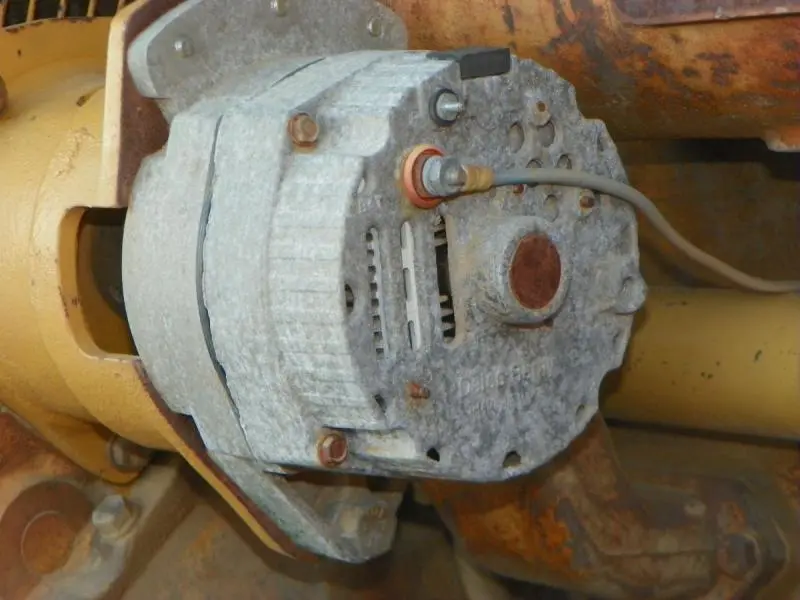

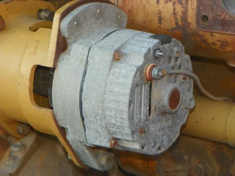

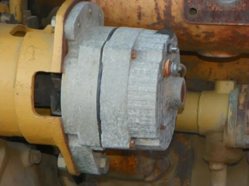

I have a D7 17A with a Delco Alternator. It is direct driven by the Generator gear (via a coupling (Its name escapes me now)). There isn't a label of any kind left on it. It has four terminals: Batt, R, (under plastic cover on top) 1, and 2. This is a 24V system (apparently the voltage regulator has been changed).
Does anyone know what the model number might be?
If I jump Batt and R it briefly charges (per ampmeter) and then quits. Do I have to do something with the 1 or 2 terminals (with a switch, etc.) to get it to charge?
[attachment=45140]100_0492.jpg[/attachment][attachment=45142]100_0493.jpg[/attachment][attachment=45141]100_0494.jpg[/attachment][attachment=45143]100_0495.jpg[/attachment]
Thanks. Daron

It is a delco 10si 30 amp or 12si 70 amp. Self exciting. ( internal volt regulator) Only uses 1 wire. Sometimes takes considerable rpm to make it excite. Are the batteries low? Batt to R may make it think the batteries need a charge. Soon as it charges reg senses that batteries are up. On hot rods they run a wire from batt to terminal 2 to improve sensing. Early si alternators were wired with terminal 2 going to battery on the ignition switch where voltages are slightly less than right at the batt terminal. Give me a call if you need more help. John

As mentioned that is a 24v Delco 10SI alternator conversion with Motorola to Delco mounting flange housing.
It is a single wire conversion with low cut in rpm internal regulator. Ignore the original terminal designations as they are for the original 3-wire application. The "R" terminal is for a electric tachometer that would only read correctly for specific rpm installations. Complete replacements are available (about $110) or individual parts can be had although the average auto parts store may not have the 24v low cut in regulator. Coupling is a "Lovejoy"
Wed, Oct 18, 2017 10:27 PM
To test the regulator, and brushes etc, rev it up and then use a small screwdriver etc to short the regulator tab to the housing. It is located in a D shaped hole in the rear of the housing. If regulator is faulty the voltage will immediately rise (to higher than normal if the batteries are fully charged). If there is some other problem with it, shorting the regulator to full field it will have no effect on the voltage.
They aren't too hard to disassemble and replace brushes, regulator etc. Easiest thing is to take it to a shop that works on starters and generators etc. It should be an easy fix for that kind of shop. If you want a new one you can find a 10SI 24 volt Negative ground with the standard housing online at places like Rare Electrical etc. You would have to swap the main housing to the Motorola type. Just have to pin the brushes back in the holder before reassembly and pull the pin once it's back together.

Jumping terminals on a one wire unit isn't going to produce anything. Control is all internal in the regulator.
Alternators configured for that conversion arrangement should switch on at about 800 rpm.
Do a google search for 10SI marine alternators that have the Motorola flange already plus flame arrester screen if you want new. Screen use is optional.
