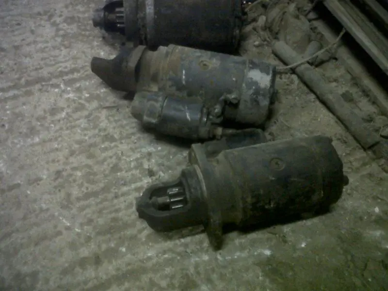

So I searched through all the old starters from the scrap heap and other dusty areas of the workshop and sheds that I could find. This was just the final shortlist from over 20 contenders:
[attachment=8378]IMG00436-20110302-1845.jpg[/attachment]
Having found one with the right end gear, seemingly the right rotation, and a small diameter that could be worked down into the housing it was disappointing to find that it was completely burnt out when I tested it. The second runner had the right gear, a long shaft and it worked. But the housing was all wrong. This means I am going to have to make a new nose cone and components in order to fit it. I dont need a bendix spiral on the starter, and dont need any form of solenoid to help throw the starter gear into the ring. The CAT part intermediate gear is on a sliding shaft and is evidently pushed into contact with both the staretr and the ring gear by a hand operated lever. This helps me to gain some of the extra reach on the starter shaft that I need, I can push the starter gear to end of its bendix and fix it out there.

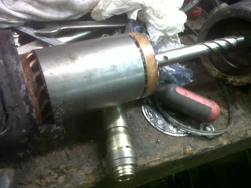

Stripped the motor down to reveal the entire shaft and the bendix spiral on it, if I can make a new front end casing for it to enclose that shaft and house a bearing, at 4" diameter, it will slide down into the CAT housing and I can fix that end gear in the right place to mesh with the intermediate gear.

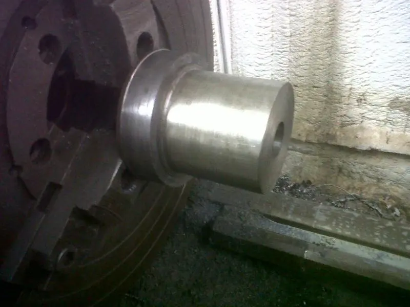

The start of machining the new end piece that will replace the existing flange on the starter and allow it to slide down into the 4" circular housing of the CAT part; more to come.

I managed to finish turning the first part last night. The long cylindrical piece is to slide down into the CAT housing, the existing starter gear and its female bendix sleeve fits up the middle. The small flange on the end butts up to the starter. The original starter end had no bearing as such, just ran in a bush, so I have just machined the inside of the piece to a very fine tolerance to allow the starter gear piece to rotate in there. The other photo shows the end of the piece that will mate up to the starter body itself, I have opened this out to give it a bit more room. Photo of the 2 1/2" drill I used to rough this out on the lathe.
[attachment=8383]IMG00433-20110302-1807.jpg[/attachment]
I had a slight technical problem here as the only blank billett I had, whilst big enough diameter to make the piece that slides down into the CAT housing wasnt big enough to be able to turn down the match up into the starter. I now have to make a short piece to connect the two, this is a help anyway as it allows me to work on the starter mods in sections.
