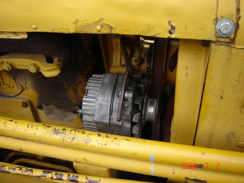

The 6V generator can be rewired to 12V. I believe they use the same armature and change the field coils.
This is probably the missing picture....that's a CME (Florida) adapter 305-633-1524. Uses Lovjoy coupling and retains cooling fan unlike some others. Shown is the Motorolla alt which can be changed to a Delco Remy 10/12SI with the three bolt housing adapter available from

hope this helps works very well

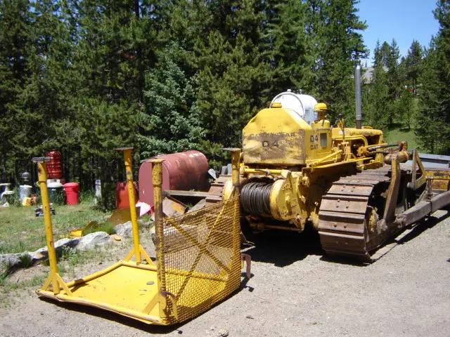

Here's a pic of a gizzy I built to put an alternator on a D4 7U. Some thinking, a little measuring, some cutting and welding, a little wrenching and viola, alternator was mounted.

steve it puts out 40 amps at idle i turn the alt just fast enough to get the job done doesnt take much if you use it one wire you have to up the rpm to get it started but i added 12 volts through switch charges instantly at low rpm and is much better on output yes thier is room for up to 6 in pulley
