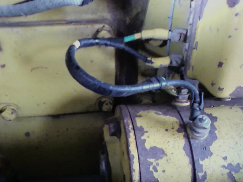

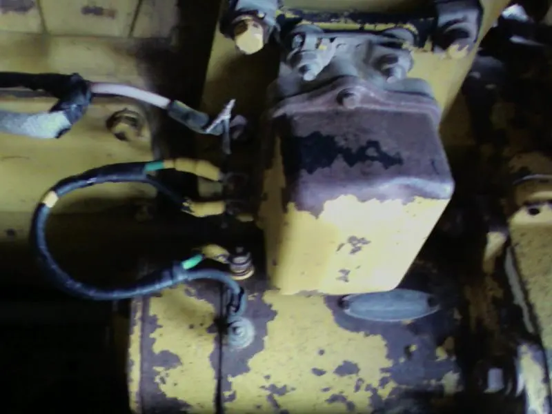

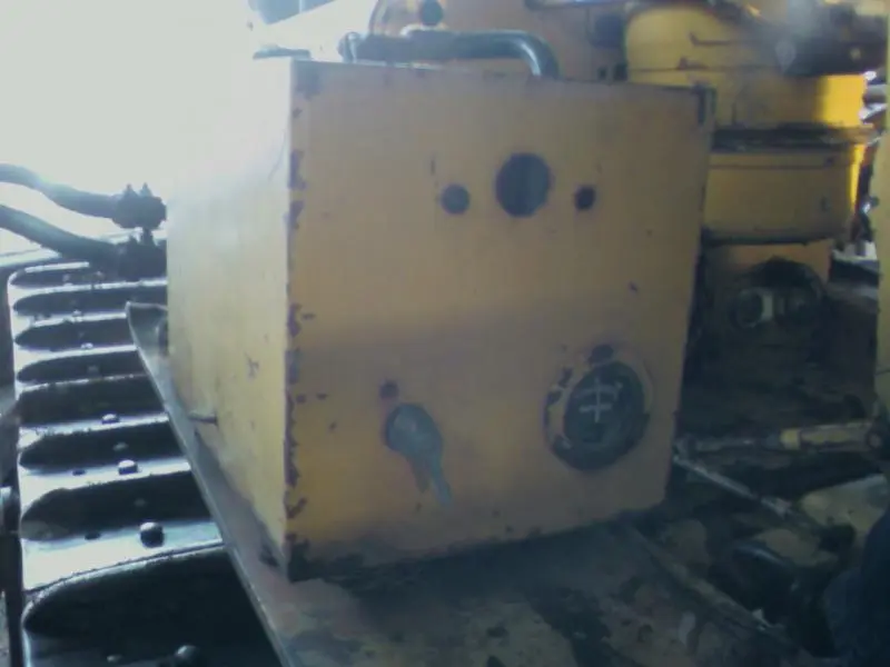

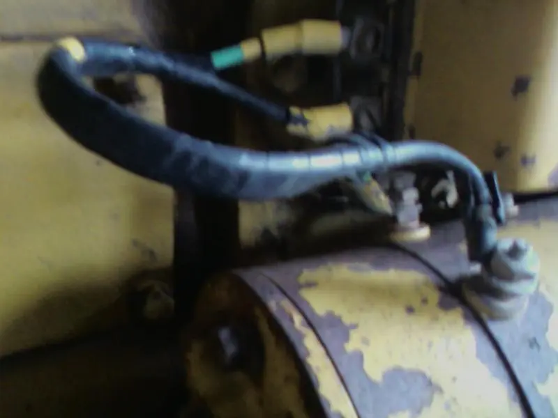

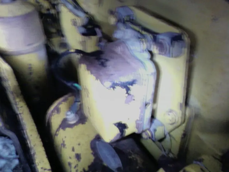

Hi OM. Looking for similar info for my D4-6U-12286. The generator isn't hooked up but is there with regulator and wiring. Gen number is Delco Remy model 1102734 serial 6K18. Looks to me like the type-2 6-v setup looking at the parts manual. I think this machine had two lights front & one rear judging from wires remaining. Has "dash light", bat. box w/ammeter and electric pony start from seat. Some bad "phone" pics - Can you confim 6v TYPE 2. I assume its not being used due to issue, is there something common that fails unique to these or is it just brushes and an R&R? Will check with a meter this weekend and see if its putting out at all. Could just need field excited! Or a gunked up armature.
Thanks - Bob

Yes, the 1102734 Delco generator (Cat # 8F3333) is the 6v-18a unit as referred to as type 2. It should be matched to a Cat # 8F3335 or Delco # 1118377 regulator or a Cat # 1L3468 Delco # 1118377 regulator.
At 18a 115 watt this unit is considered to be a two lamp arrangement along with battery charging. If your considering running 4 lamps it should be upgraded to at least a 200 watt unit....three is sort of in the middle and might compete with battery charging. The sealed beams require 6-8a each. (1 watt per candle power)
This is a "A" circuit generator so polarizing is done with all the regulator wires hooked up to the proper lugs and just touching a jumper between the "Bat" and "Gen" terminals at the regulator.
Most common problem is brush issues but it can grow from there.
