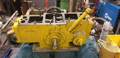

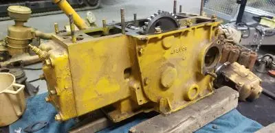

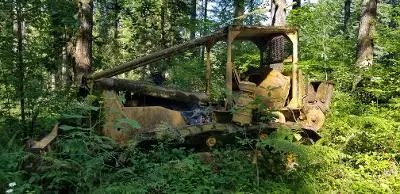

Well guys here we go, This is where she has been sitting for 20 plus years, Im going to put new filters on her and flush the fuel tank, I also cant thank Allen from gaston Oregon for finding the pony motor in the thousands of parts he has, It is a remanufactured block with new pistons and Crank and the works. They didnt even know he had it. Ill be getting a 750 dozer to push her out and get her going. Ill get the pony installed and hope for the best. Ive rebuilt the pony carb and have all the gaskets I need to get her installed. [attachment=62285]D6 1956 9U.jpg[/attachment][attachment=62286]Pony1.jpg[/attachment][attachment=62287]pony2.jpg[/attachment][attachment=62288]Pony3.jpg[/attachment]

Take a sample from each oil compartment and the fuel tower drain to check for sludge or water. Reliability depends on cleanliness. If you do find contaminants, consider not running (or moving it if it's in the transmission back) until you get the offending chamber cleaned out.
Thanks so much Neil, I will check everything I can, I have ordered new fuel filters, oil, etc. I have removed the fuel tank and will clean it out. I'm having the pony motor fuel tank cleaned also.
I will make sure she turns over freely before I attempt to start it. I'm thinking maybe I should turn the compression release on and turn it over as I push it slowly. ????
Any advise would be truly appreciated.
Thanks again.
Mike
